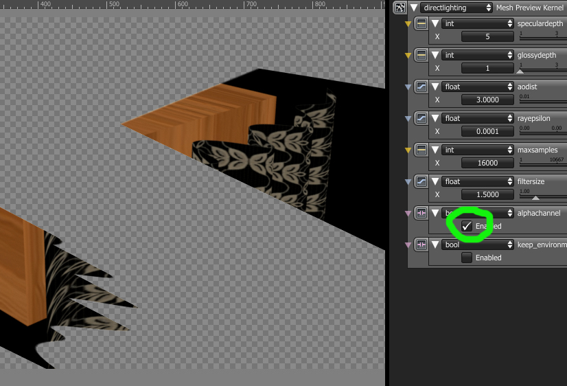

oguzbir wrote:This version is a very good update. Thank you guys.
Just to help you solve problems for further versions. I have a bug report.
I have just came across with a problem while testing it with an old scene. And sadly I was able to re-create it 3 times.
Pathtracing on , Daylight on, alpha mode on
Rotating viewport gave the problematic screen below. The alpha problem occured after enabling the daylight mode.
Tried to recreate it with a single material node with pathtrace and daylight on. It didn't happen. It seemed OK.
Now, I tried it with another old scene the problem occurs again.
Keep environment option doest not help.
Edit----
My Nvidia version is a beta - v 266.35 . (I think I must stress that out)
Thanks for the files. I found the problem and it was easy to fix. Until the fix becomes available, please make sure that the image width is a multiple of 8. In your case, switching from a width of 900 to 904 makes alpha work again.

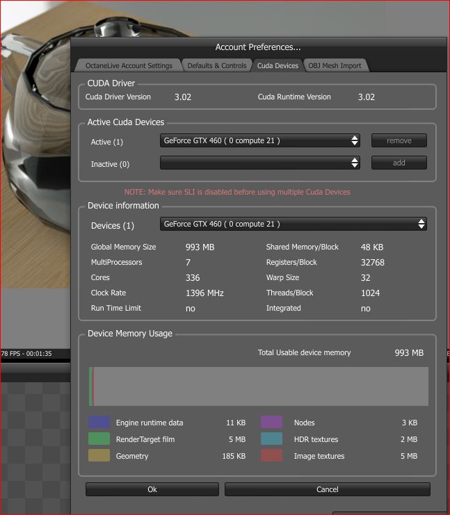

Thanks for the new version.I can finally use all 336 cores on my single GTX460.I also have to report that i can drop it to my task bar and still use other programs without the display feeling jerky.This may only because i have tried it with a simple test render of the teapot though.So i will keep you all informed.One query.I am using the latest driver 260.99 and i know you have compiled it using Cuda 3.2. However my account preferences screen wrongly displays Cuda 3.02 ? .You may need to look at that.Small point i know.
CPU:-AMD 1055T 6 core, Motherboard:-Gigabyte 990FXA-UD3 AM3+, Gigabyte GTX 460-1GB, RAM:-8GB Kingston hyper X Genesis DDR3 1600Mhz D/Ch, Hard Disk:-500GB samsung F3 , OS:-Win7 64bit
Jaberwocky
Posts: 976
Joined: Tue Sep 07, 2010 3:03 pm
Sorry.Forgot to post the screen shot

abstrax wrote: Thanks for the files. I found the problem and it was easy to fix. Until the fix becomes available, please make sure that the image width is a multiple of 8. In your case, switching from a width of 900 to 904 makes alpha work again.
Cheers,
Marcus
Thank you
It really worked.

Jaberwocky wrote:Thanks for the new version.I can finally use all 336 cores on my single GTX460.I also have to report that i can drop it to my task bar and still use other programs without the display feeling jerky.This may only because i have tried it with a simple test render of the teapot though.So i will keep you all informed.One query.I am using the latest driver 260.99 and i know you have compiled it using Cuda 3.2. However my account preferences screen wrongly displays Cuda 3.02 ? .You may need to look at that.Small point i know.
Yes, that's a little weird, but the internal version number of CUDA 3.2 toolkit is indeed 3.02. Ask nVidia about that... ;)
Cheers,
Marcus

Maybe I found a mistake.
Every time i turn on alpha channel, screen is getting wrong.
I tried directlighting, pathtracing, daylight ... It makes always.

oguzbir
Posts: 715
Joined: Fri Jun 25, 2010 12:30 am
mirobimbo wrote:Maybe I found a mistake.
336 cuda cores on my 460 work fine :) .
Sorry my English.
The workaround for the problem is already posted a few posts up..
your image dimensions has to be multiple of 8
