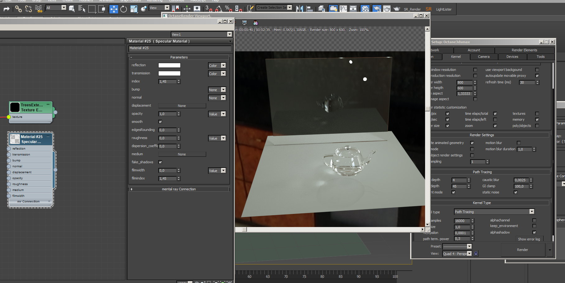

Found an inconsistency.
The caustic material is disabled.
HDRI - creates caustic - thus it must be ?
