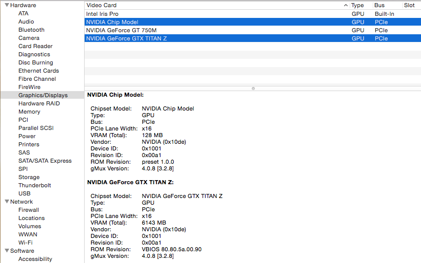

You can try this for Yosemite. They show how to edit the web installer files so that you can install the drivers on a macbook pro:p3taoctane wrote:Thanks Jose
It looks like I would have to role back from Yosemite to Mavericks as the moded wed Driver for nvidia is ONLY mavericks 10.93 and 10.94
I'll work on that and see how it goes. I am not sure how much that will effect all the apps I have now so I am hesitant to do that just yet.
But I will get there eventually.
You sent a link showing how you can turn a molex into a barrel to charge the PCI slot ... why not use the barrel that comes with the Extender?
Is there a reason not to? Is it not powerful enough etc?
Thanks Again you are a great rersource and it seems one of the few that have got this working :>)
Peter
Macbook Pro GT750M + GTX780Ti@16Gbps-TB2 (Sonnet EE III-D) +OSX10.10:
http://forum.techinferno.com/implementa ... -10-a.html
How to Install Nvidia OSX Drivers on Unsupported Systems:
http://xellers.wordpress.com/articles/h ... d-systems/
Molex to barrel - is if you want to put the GPU straight in to the AKiTiO and not use the riser:
http://forum.techinferno.com/diy-e-gpu- ... post115654
Thanks man! Im just trying to help my Octane Render people.
Let me know if it works for you.
