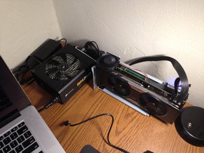

Incase there is future interest in this, here is a photo of my GTX 780 eGPU Macbook Retina build. I just got her running today. Setup was surprisingly simple and I haven't come across any cons to this setup. Once the drivers are installed, it is essentially plug-and-play operation.
For the record, a main reason I took this route instead of building a new desktop machine is I edit video a lot and My Macbook Pro Retina handles that task excellently, especially with the internal 1TB flash drive. It's very nice to have everything running on 1 machine of course, so now I have it all under 1 roof and portable.
The cost is nice as well. It ran me $400 + video card.

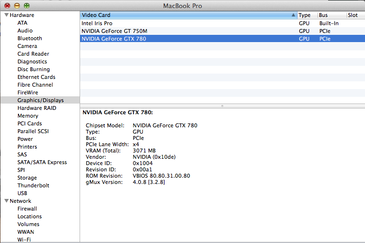

Windows only, right?
garytyler
Posts: 234
Joined: Mon Nov 10, 2014 7:40 am
Location: Portland, OR
Nope. It's running on Mavericks just fine. I don't plan on updating to Yosemite for a little while so I can't speak for that. I usually like to let bugs and updates catch up.

It does involve some kext editing. I followed the instructions at these 2 links. I don't have much savvy with this kind of stuff but still got it up and running in no time. It makes sense that if something isn't marketed as an "eGPU", there won't be support for it. But, it also makes sense that changing these few Kext files would allow the GPU to be accessed by the OS through Thunderbolt 2, because Thunderbolt 1 & 2 are a PCIe based. From there, it operates like any GPU, only without the speed of a direct PCIe connection which appears to be negligent because Thunderbolt 2 is really fast both ways.
Also, I just upgraded to a Titan Z today. I was curious how much of a speed increase I would see. So far, it looks like an average of about a 30% speed increase compared to the GTX 780. In a normal desktop system I would possibly see more but the 6 GB vram was part of my reason for the upgrade. One thing I'm curious about is running another eGPU on my 2nd Thunderbolt 2 port. I don't see why this would not be doable for Octane rendering. If I get the cash saved up, maybe I'll give that a shot.
Also, I am able to edit 4k REDRAW video in Premiere Pro on my internal GT 750M while simultaneously rendering on Octane High Priority on the Titan Z. I call that success.
