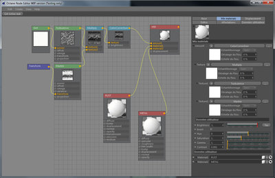

To late... pxlntwrk has been faster than me. :)
Here the node structure of the tutorial. Be carefull, ColorCorrection has changed since this tutorial.

@atome451, thank you too for the shadertree image.
