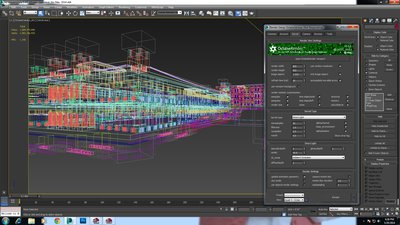

With this new version i am facing below problems..
1. i m not able to get render view-port done (it is showing black..)
2. when i was using previous version 1.5a, i that on view poet 3 buildings were open and when i turn 4th building whole building turns to black and at some places there colors also changes.
The same project is running very stable and smoothly with 1.20. and it is rendering in 3 min with full HD quality 1200 samples
pixelsolution
core i 7 4700k / 32 gb ddr 3 1600 ram / 2x titan.

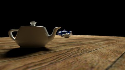

Background image works great - any possibility of being able to use animated sequences? It always shows the first image of a loaded AVI.

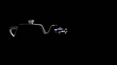

Looks like there is a problem with matte material.
This is with normal diffuse floor :

this with matte checked on floor
teapots should still receive the bounced light and reflections of the floor like in the above image.

pixelsolution wrote:Hi Karba
pixelsolution
What is your texture statistic?

darkline wrote:Hey Karba,
We made this change because of this issue: http://render.otoy.com/forum/viewtopic. ... 60#p176560
Here is an explanation how it works now: http://render.otoy.com/forum/viewtopic. ... 10#p177710
In a nutshell: You have to use a background that matches at least roughly the backplate you want to use later for compositing, which will then camera mapped onto the matte surface and used for secondary rays i.e. reflections/refractions.
