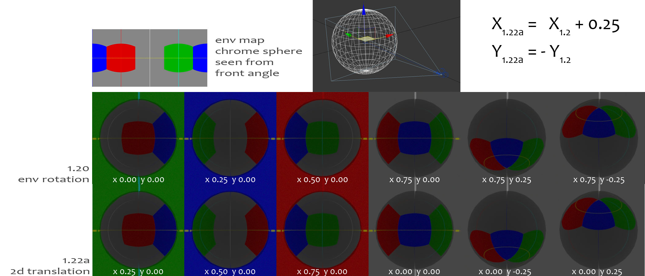

Bug[email protected] wrote:I just noticed that... I have a HDRI with 4 light planes, and one of them is ultra bright, what you say is correct, rotation is set to 0, and I see the brightest planebicket wrote: do you notice that environment rotation has gone ? You have to redo the rotation with 2D transform (translate)
OctaneRender® for 3ds max® v1.22a[Test]
- Elvissuperstar007
- Posts: 2538
- Location: Ukraine
- Contact:
Win11/msi x79a-gd45 (8d)/ Intel Xeon e5 2690v0/ 64gb DDR3 1866/ Nvidia 4090 Asus TUF/ be quiet! Straight Power 11 1000W 80 Plus Platinum
- [email protected]
- Posts: 134
- Joined: Tue Jun 01, 2010 12:52 pm
so if my value on rotation was 0.071, and other was 0.0
in 2d transformation it should be 0.321 and other 0.0?
if this is correct... I still don't get the same result
@ Elvissuperstar007 - it's not a bug, that object is moved in back by accident, that's why it's darker...
Windows 10 64bit, Intel i5, 32gb Ram, 2x nvidia 1080ti, Driver: 390.77
[email protected] wrote:so if my value on rotation was 0.071, and other was 0.0
Here is my quick test inside 3dsmax
