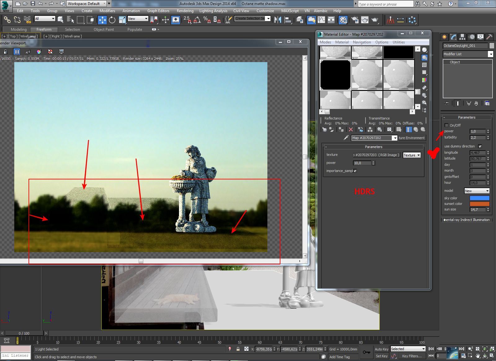

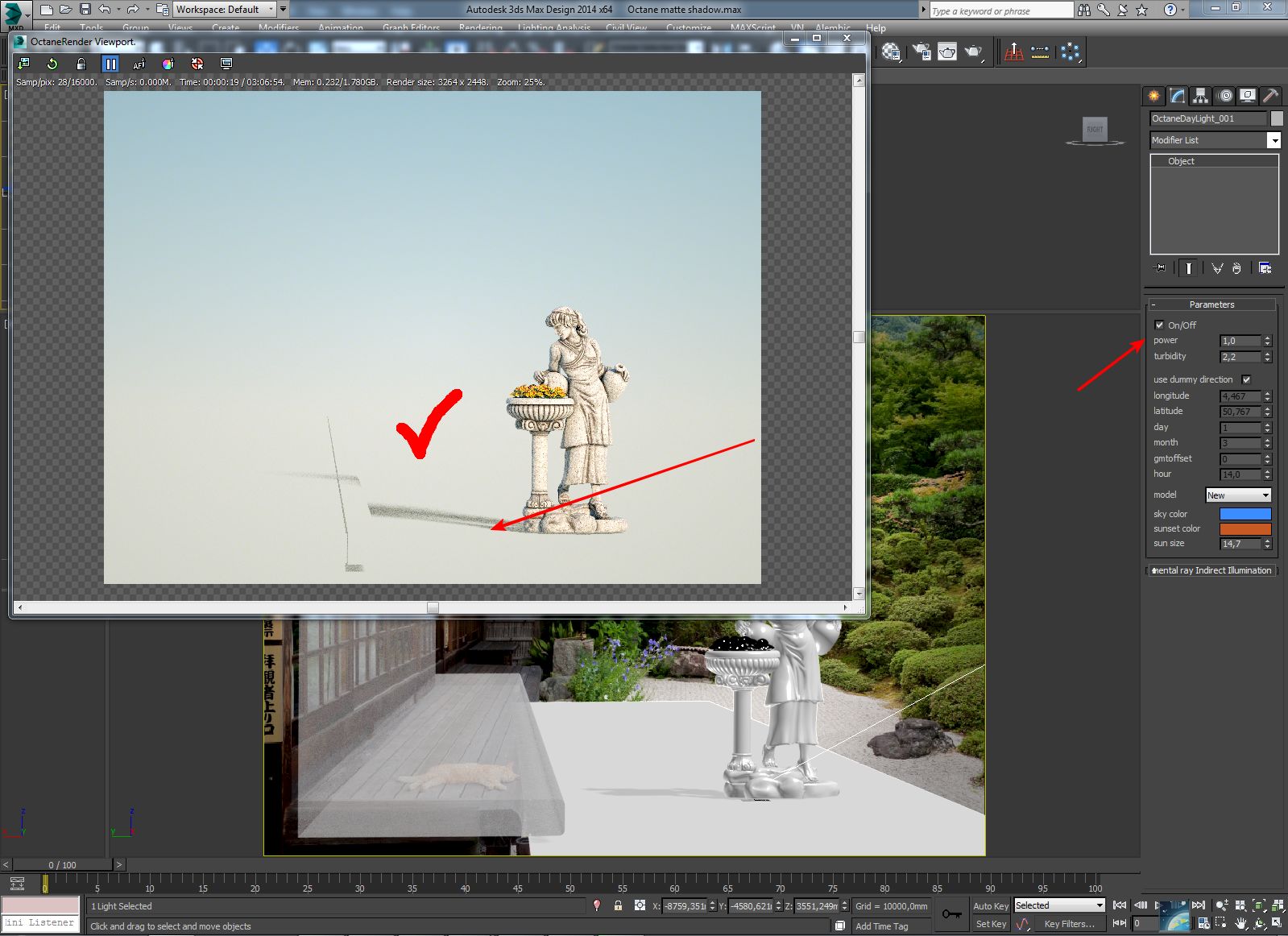

Bug HDRS matte shadow 1.22a
Karba
Posts: 2300
Elvissuperstar007 wrote:Bug HDRS matte shadow 1.22a
Switch off cast shadow properties on matte object.

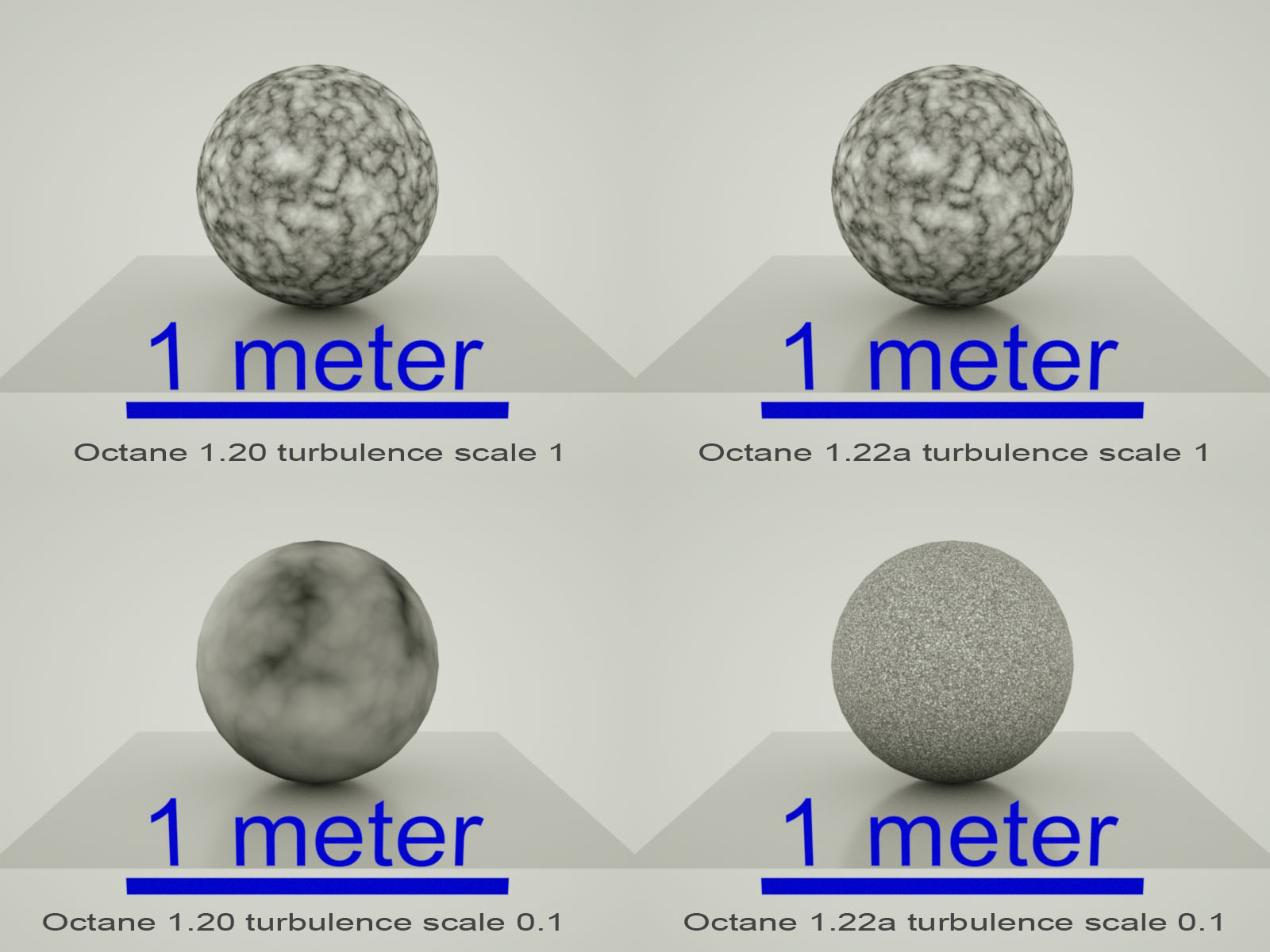

Karba
I found something strange in the scale transform (compared to 1.20)
PortFolio
