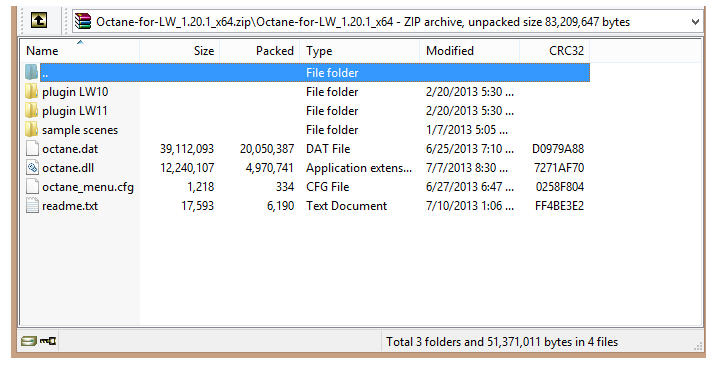

This are the dates and sizes of the Octane.dll and Octane.dat file that I can see in the 1.20.1 x64 .zip file.
