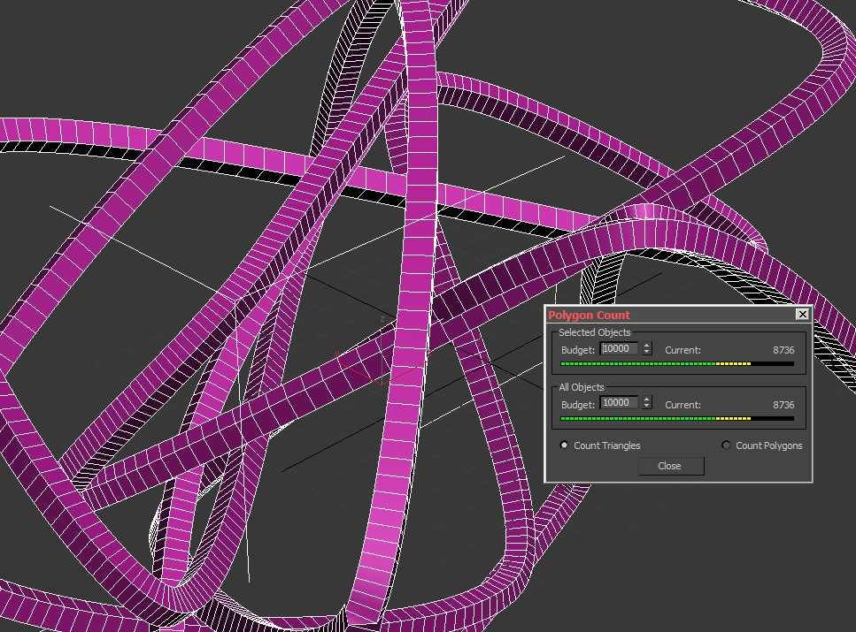

Hey Karba, there's a bug with line in rendering.
RC3
Max 2010 64bit
GTX 690

awsjolie wrote:Hey Karba, there's a bug with line in rendering.
No bug. Just apply EditMesh modifier.
I know that, but it will increase amount of poly for nothing, cause i not only have no needs to edit that mesh but also prefer to edit it in line :roll:
This issue does not exist in the past
gueoct
Posts: 402
Joined: Mon Jul 11, 2011 3:10 pm
awsjolie wrote:I know that, but it will increase amount of poly for nothing, cause i not only have no needs to edit that mesh but also prefer to edit it in line :roll:
??? What do you think 3dsmax is doing when you apply a thickness to a line? it creates polys...
so the polys are there anyway, if you apply an EditMesh or not
You can still edit the line as line just put the EditMesh modifier on top of your stack,
so that Octane recognizes the thickness of the line. Easy! :-)
awsjolie wrote:This issue does not exist in the past
It´s true. This issue exists since version beta 3.00d... in V 2.58f it was still working without tricking!
Im not sure abt this... but when you have a line and choosing EditMesh in Modifier list or convert the line into Editable Mesh, 3dsmax will recognize its a Mesh with lots of additional polys. You can see this at Statistics :D
gueoct
Posts: 402
What else could it be than polygons...?
Intel i7-970 @3,20 GHz / 24 GB RAM / 3 x EVGA GTX 580 - 3GB

awsjolie wrote:
I think you are wrong :lol:
I think so. Thanks to gueoct :D
gueoct
Posts: 402
awsjolie wrote:
Thanks to You i realized, that this issue did not exist in the past! :-)
