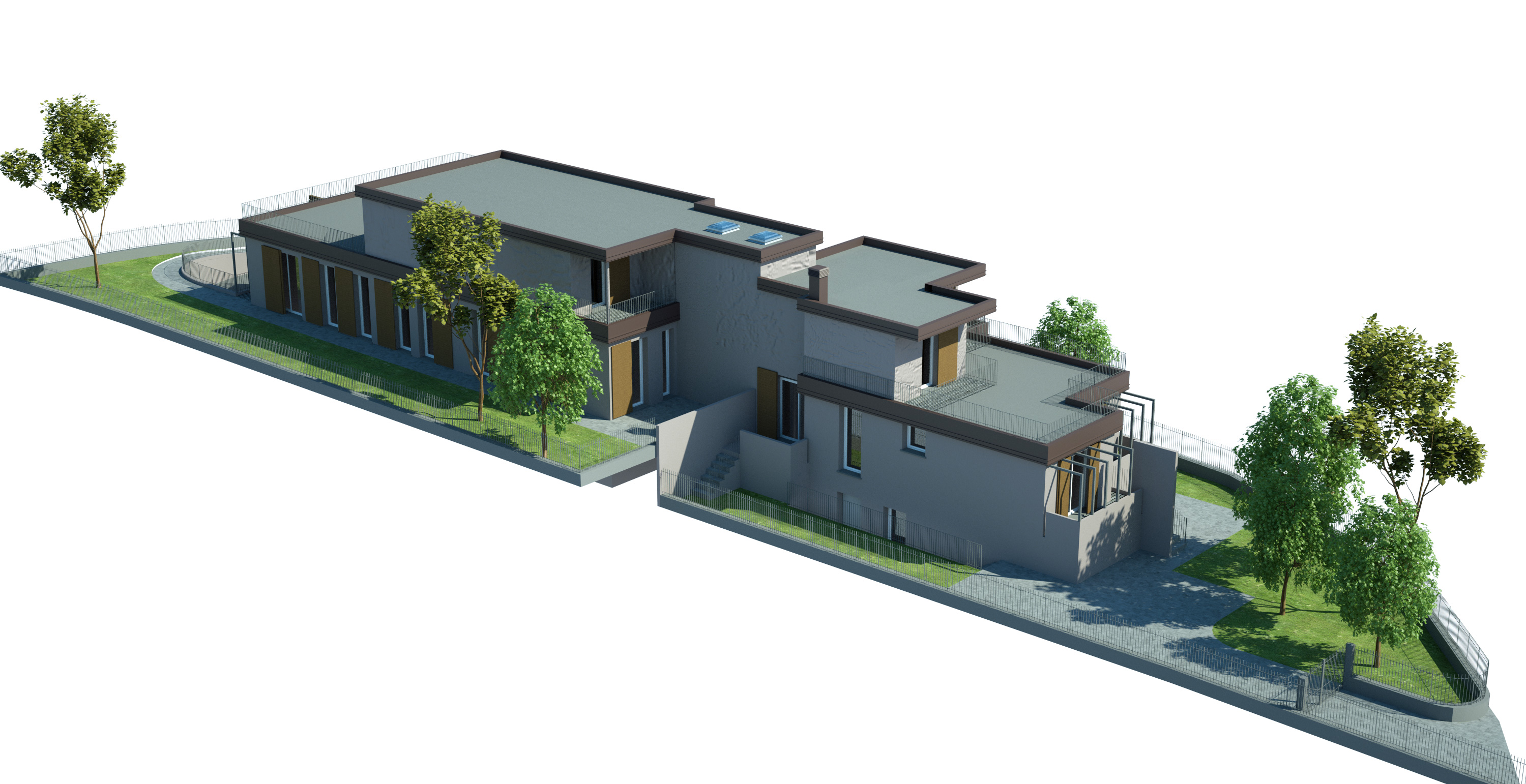

Same scene, same materials, same settings, but completely different times:
File no instances _ computation time 48m
File with instances (trees) _ computation time: 1h 20m
How is this possible? Should be much lower time to calculated render with instances!
it may have changed the kernel and can result in a greater cleaning in less time? Or are there any problems?
SORRY, MY ENGLISH IS BAD!
2 Xeon quad core E5440_8gb Ram_Nvidia GeForce 2GTX 780ti 3Gb/Nvidia Quadro K2000_Win10 64bit_Octane 3.02_Rhinoceros3D
roeland
Posts: 1826
With instances you will have lower memory consumption, but the rendering is less efficient.

why?
I understand that this feature is ok for 100.000 instances but for one light and one teapot is not good.
one light (instanced by default) and one teapot less performances.
one plane mesh emitter and one teapot good performances.

i think that the comparison must to be done from the scene with all the objects not instanced to the same scene with all the possible objects instanced :roll:
could you render the same complexity without instances?

hello to all,
honestly it all seems confusing! ok roeland that is a saving of memory but it is incomprehensible lower performance ... instances allow you to create scenes with many objects but should be at least performing the same way!
if I have a scene with "only" 10 trees in terms of speed should not use instances, at least as long as I have memory in my VGA!
