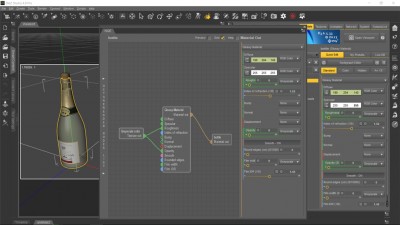

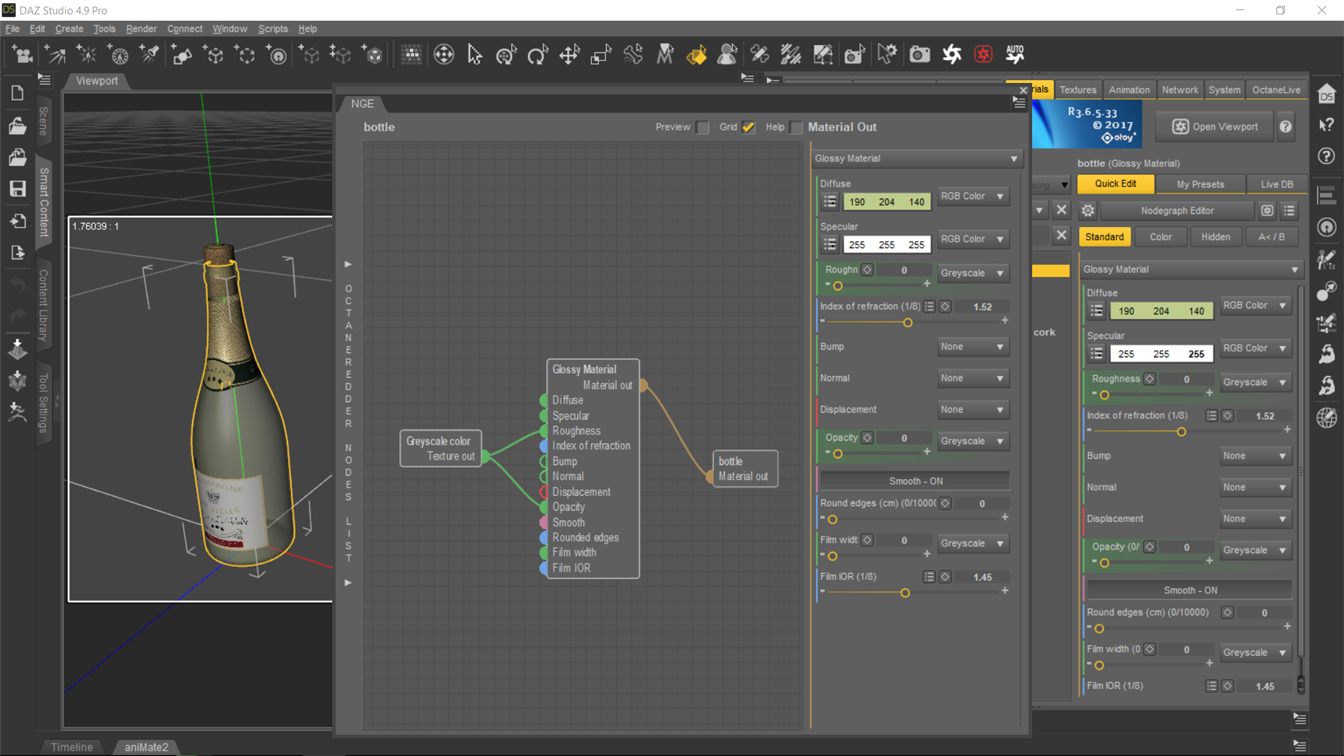

However allow me to use the same bottle that still has the issue persisting, it should be analogous to the EyeMoisture. I think it's safe to assume that there are other figures and props that are still affected by the issue, I will report it if I find it.
Sorry, should've shown this earlier. As you can see Roughness and Opacity are connected to the same Greyscale node. The same thing that used to happen to the EyeMoisture

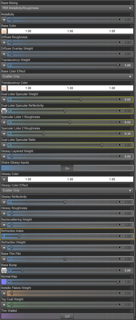

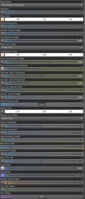

Not sure how you want me to show you the DAZStudio Shader, so here is a screen showing the Gloss and Roughness related settings. If you want the shader preset file pls let me know, I will PM it to you.
Can you post screenshots showing the rest of the shader pls?

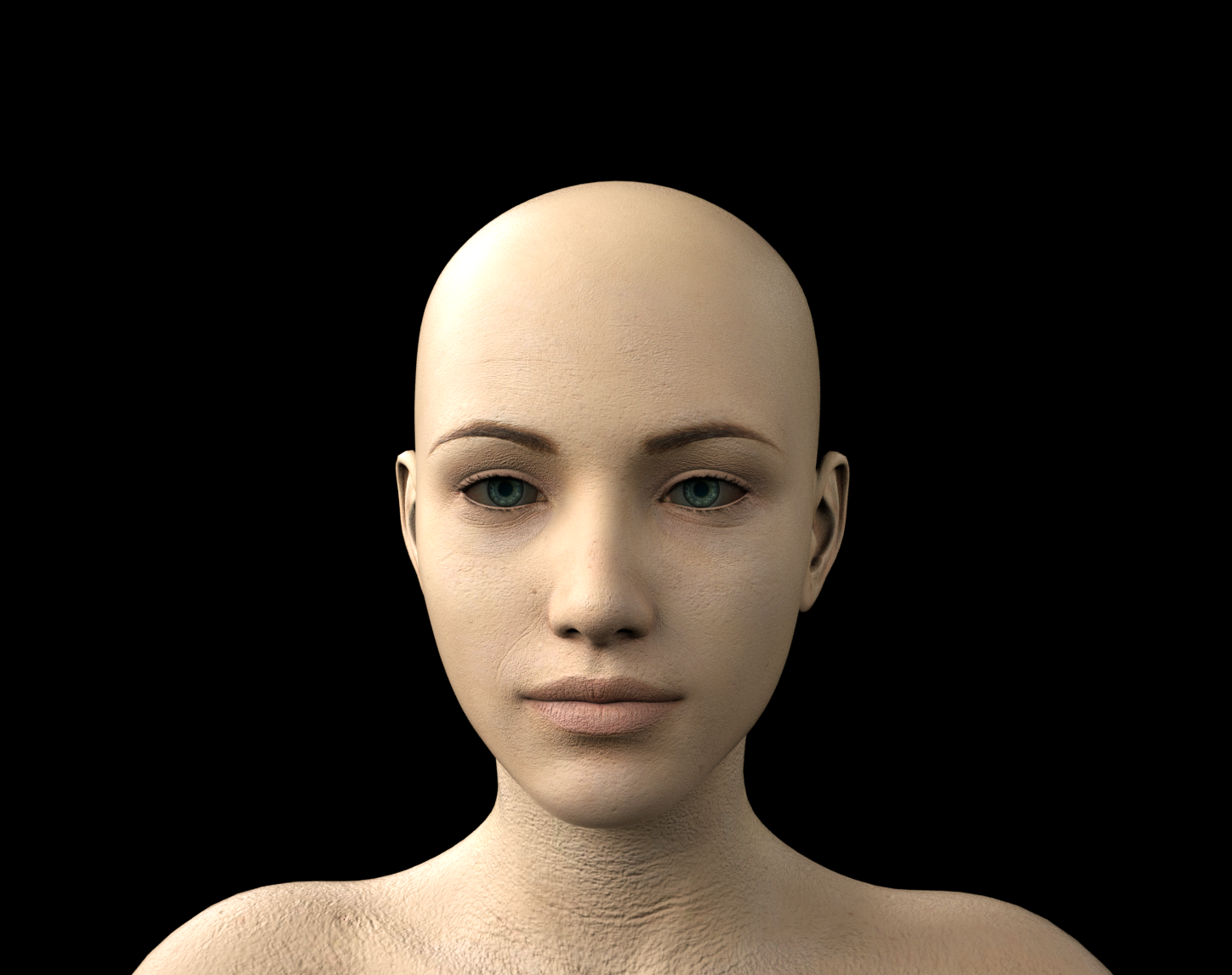

I think there is a problem with G8F default material conversion :o
latest plugin version 3.6.5.33 of june 16
TRRazor
Posts: 684
Joined: Sun Nov 03, 2013 10:21 am
It's not a conversion issue, it's the maps DAZ3D uses in their new skin shader. They take a heavily yellow-filtered diffuse and blend it with a red-blue SSS map to achieve a half-way realistic skin color. Unfortunately - at least at this point, this blending isn't implemented in the standard conversion yet.
Our upcoming RedSpec SSS shader update for G8F will actually fix this, you can see the result here: http://trrazor.deviantart.com/art/Victo ... -686824238 and here http://trrazor.deviantart.com/art/RedSp ... -686621863.
It also looks like the bump is too high. I would be interested to hear others experiences. You can change the bump conversion factor in the Preferences tab.

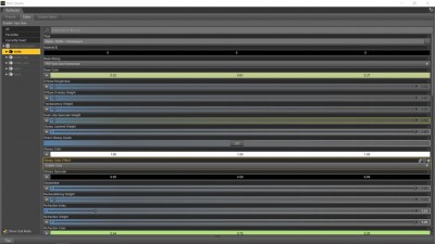

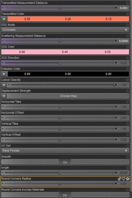

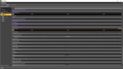

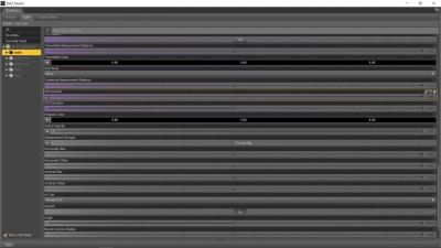

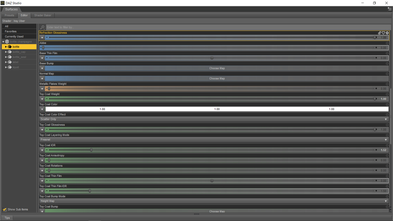

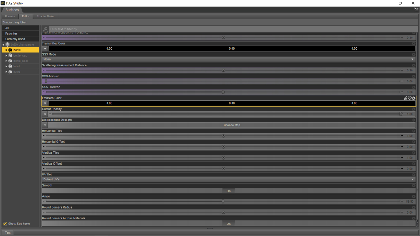

Certainly, here they are.
#2
#2
#3
#3
#4
#4

garand3d - I cannot reproduce the problem you are having if I use a material as per your screenshots. Are you able to send me a scene with that material used on a cube primitive pls?
