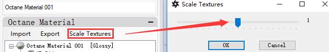

Thank you for your help. I see the OctaneChangePinValue command was improved. Thanks,I love this. And does this OctaneChangePinValue command suppper to OctaneRender for Rhino 2.24.2.56? I need to use this version.
I found one problem. Can you make a slider button for the hdri texture environment rotation by the Z-axis rotation angle? Just like a quickly tool likes Scale Textures slider button.
Does it possible?
Best Regards,
alxen
face_off
Posts: 15822
Location: Adelaide, Australia
Done - pls see the STABLE release thread.
You can already do this by opening the Environment->Texture->Projection->Sphere Transformation node and moving the Y Rotation slider.

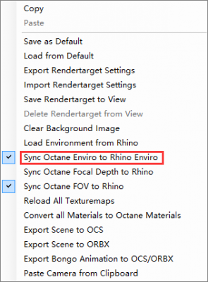

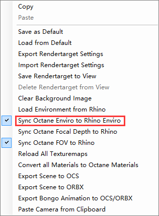

Hi Paul,
I also need the OctaneScript command to support for this, like this:
I need to set it every time. I hope one script command for solve this.
Thanks for your help.
Alxen
face_off
Posts: 15822
Ah yes, sorry, I will put that in the next release.
