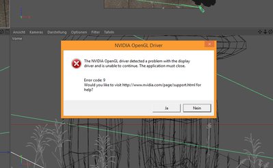

Hi Ahmet,
I did some tests with new beta 2.0.24, SDK 2.01:
C4D crashes with an OpenGL issue when opening a simple scene that I created in 2.0.22, SDK 2.0. Error is this:
It was the same with 2.022, SDK 2.01 so I switched back to 2.022, SDK 2.0.
Will generate error log if needed or helpful.
Ciao - Ron
EDIT:
I realized that the crashing unfortunately is related to viewport settings. Switching to top view that uses Gouraud-Shading causes the crash. After changing top view to lines all is fine. Will test this with 2.024 SDK 2.01 too.

Hi Ron,
what's your driver version? It looks like a opengl problem.
