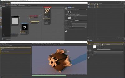

Hi Ahmet,
unfortunately this version is far from being stable on my side. It's crashing after minutes of doing something in node editor.
Just tried the new NE functions while making a simple material with noise and displacement. Tried that several times with same result.
Bugreport and Oct. Log below
Using R21, latest before S22.
Best - Ron

Did you delete texCache?
Did you try without denoiser and RTX?
send me a video from crash moment
protokol

Yes - deleted cache, disabled denoiser. Video here:
https://www.dropbox.com/s/3tga8b2wcmh7o ... 1.mp4?dl=0

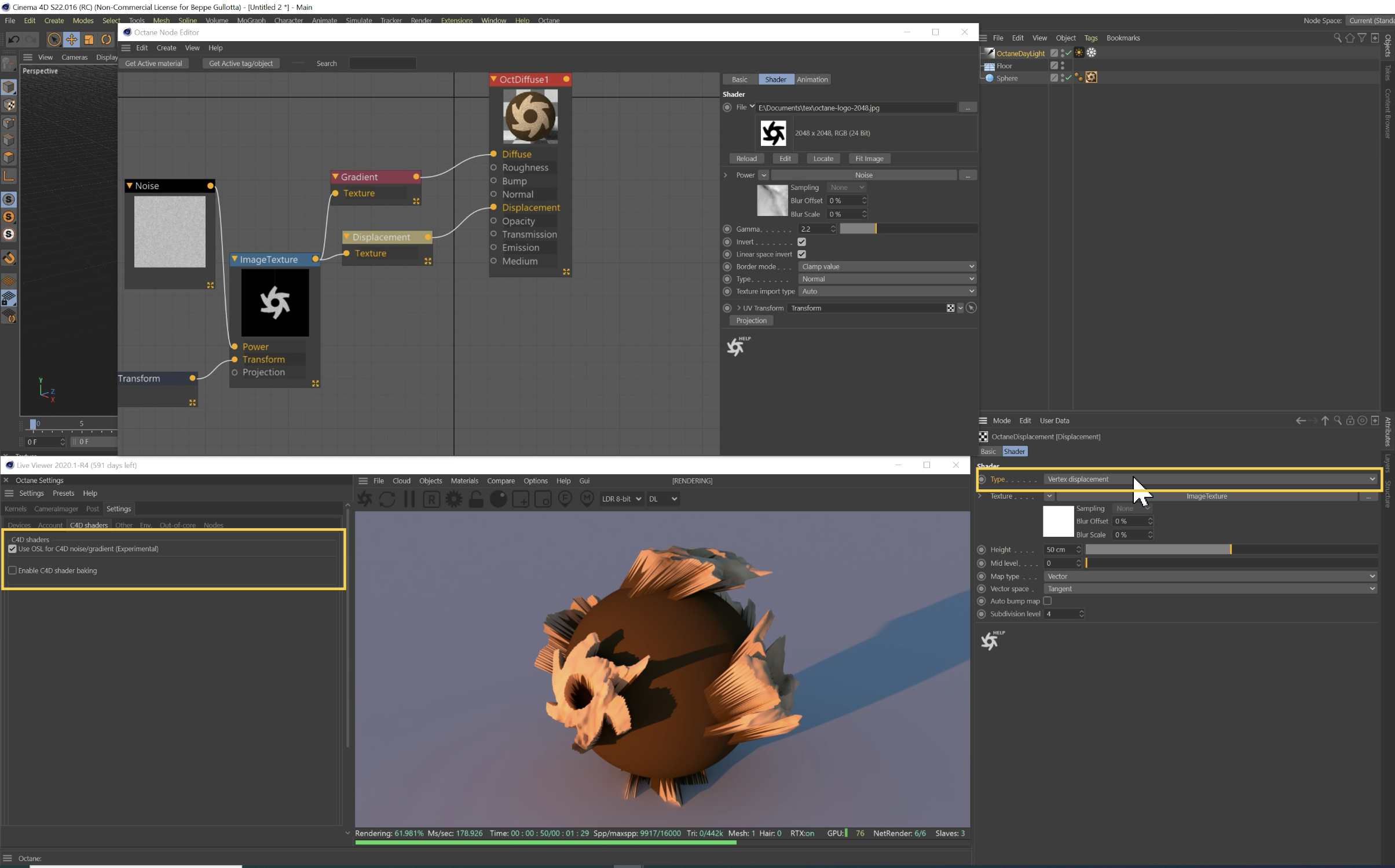

Hi Ron,
please go to c4doctane Settings/C4D Shaders, and make sure that the “Use OSL for C4D noise/gradient” option is enabled, then do again the same steps:
If the option is not enabled, the c4d Noise shader is baked into texture at each interactions, destroying the workflow.
Everything is real time if the option is enabled here:
ciao Beppe

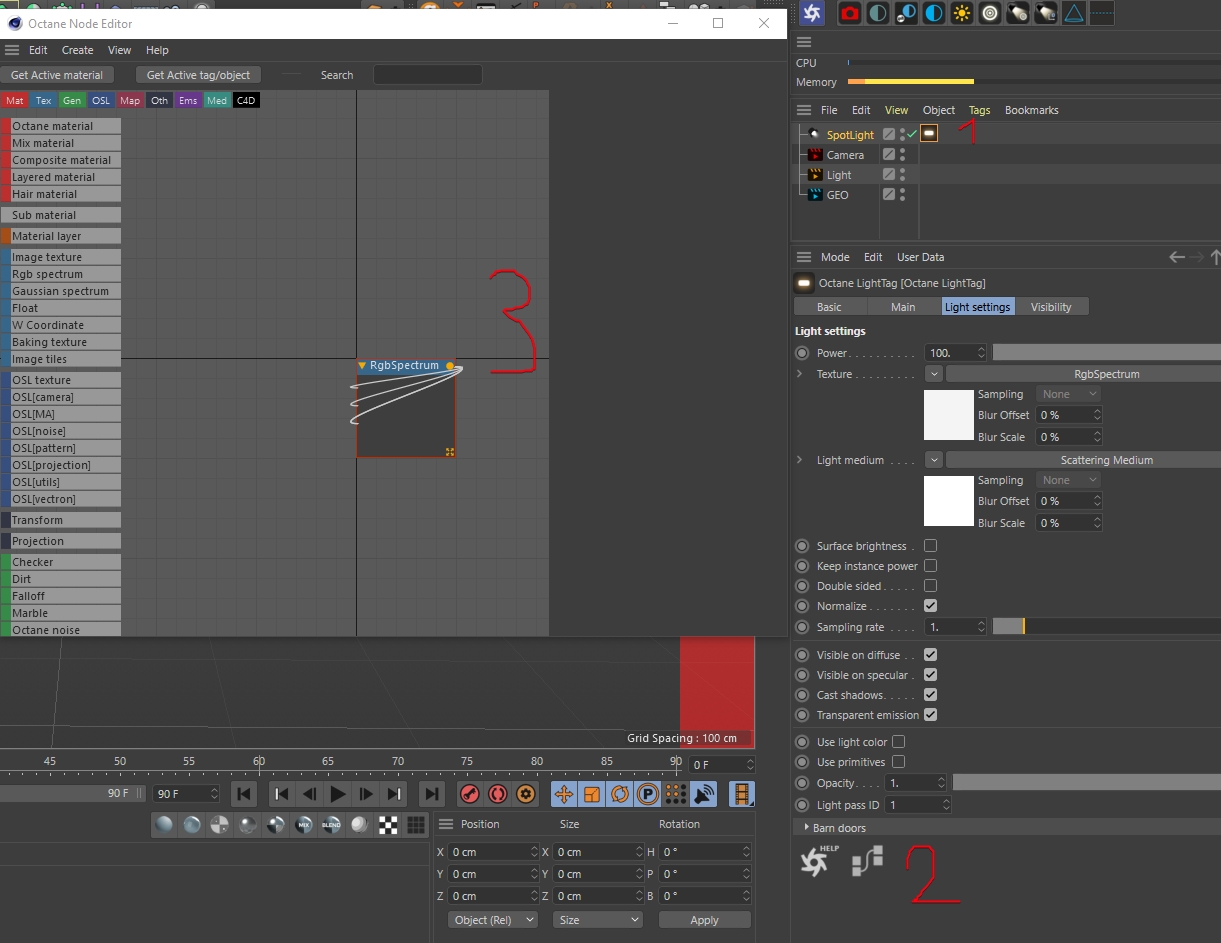

Octane Spotlight - nodeEditor
Win 10x64, AMD 1950x 16C/32T, RAM 32Gb, RTX 3060x3
Octane-for-C4D(R23.110)2021.x.x, Cycles4D, Centileo. Nvidia 472.47 STUDIO
Posts: 16068
Location: Türkiye
VVG wrote:Octane Spotlight - nodeEditor
I know it, checking

Hi Beppe,
I have this option enabled. It does not work properly.
I realized, that Octane settings are not kept after making changes.. Its always at default state after restart.
Something is not working as expected with this release.
