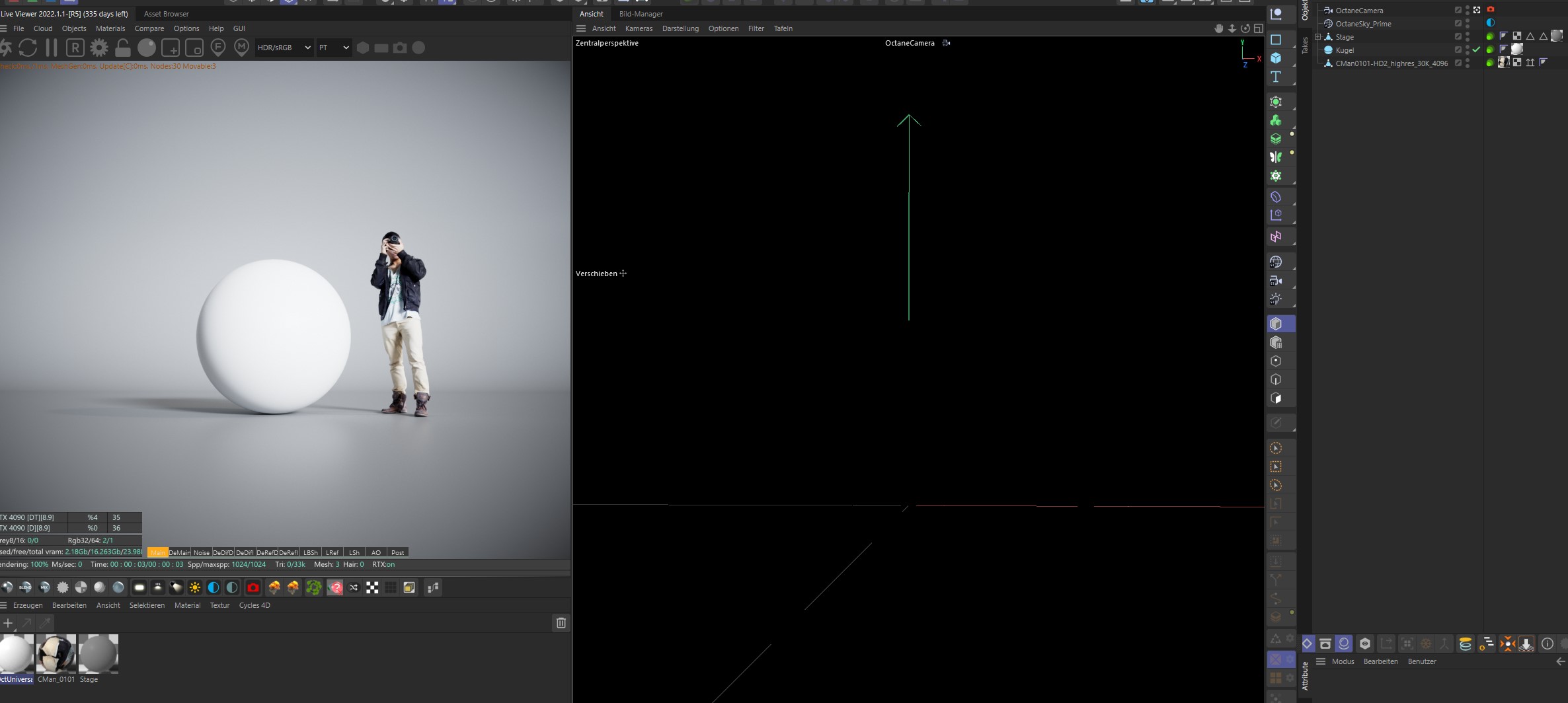

Hi again,
suddenly, after updating C4D to 2023.2.2 my viewport is completely black.
Every Object with any Octane-Material appears black in the viewport.
I can only see whats goining on when I switch to "layer-color-view" or "lines mode".
Any idear, what could cause that?
thanks
Mike

miohn wrote:Hi again,
thanks
Mike
Viewport or materials in the viewport? Both are not same thing.
thanks
Mike
every object in the viewport whis has an octane material appears black.
So I have a stage-object and 2 other objects on the stage (f.e. my startscene "new.c4d") and all is black

miohn wrote: every object in the viewport whis has an octane material appears black.
Your viewport is fully filled by objects, so viewport is not black. Covered objects are with black textures. Spend some time to play with content to gather more info.
