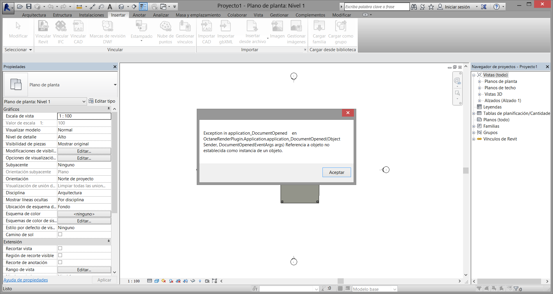

Important bug!
With the octane plugin installed when I link a IFC it doesnt work. After this window when I load the ifc it doesnt appear.
Windows with the error.
Can you pls send me an IFC file which demonstrates this problem.
Paul

I have refreshed the installers at the top of this thread with:
2.24.2.35
- Compiled with Octane 2.24.2
- Fixed issue where loading an IFC file would raise an exception. Because Revit triggers a "New Scene" event when loading an IFC file, load an IFC file will cause the Octane Viewport and Setup windows to close
Paul

Many thanks Paul!
