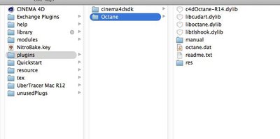

MINGATU wrote:Heres the report I got from the error. It's saying there's a problem with the r14.dylib
This is from the 2.00.xx Mac plugin.
hmm, but plugin is working. I thought that's not loading. So we are looking to wrong direction.
Can you try removing other plugins, Hot4d also? Which action is causing to this crash?

I removed every plugin except for the attached grab and it still crashing.

Hey Aoktar,
Also, running C4D r14.042 (Build RC76788) if that helps with anything.
Thank you for the help!

MINGATU wrote:Hey Aoktar,
I'm going to check tomorrow on Macos. Something can be wrong on packed files.

MINGATU
Posts: 24
Joined: Mon Jun 16, 2014 4:36 pm
Hey Tkkim,
I'm curious what specs u have running octane 2 on the mac. I"m trying to get it to work but it keeps crashing on launch.
OS 10.9.3
Nvidia Geforce 680 Mac Edition
Nvidia webDriver 334.01.01f01
Cinema4D r14.042 (build RC79788)
Thanks!

MINGATU wrote:Hey Tkkim,
OS 10.9.3
Thanks!
Hi MINGATU,
i checked r14 on macos. It's working here. But i notified some problem while checking Tkkim's scene. Macos version could have some serious problem with libs. Let me to continue testing, i'm going to give some info soon.
