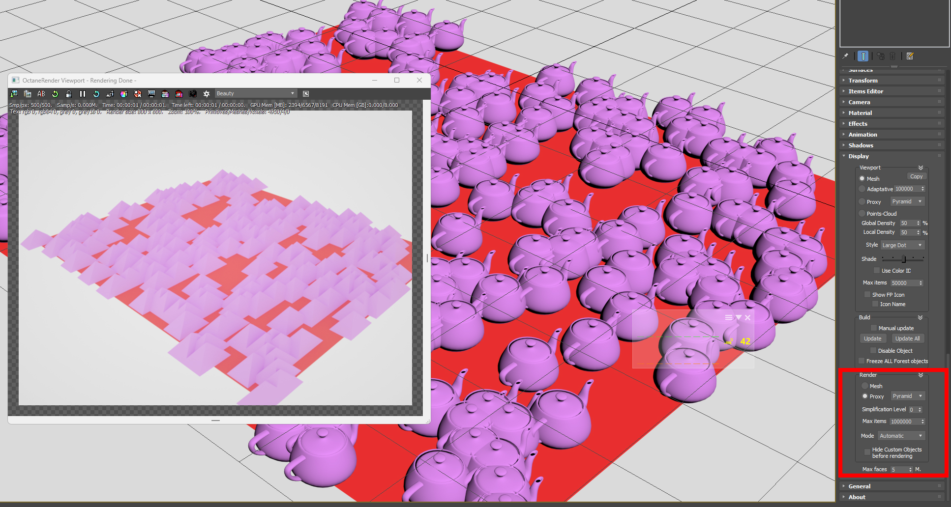

Hi coilbook,coilbook wrote: Wed Nov 05, 2025 6:31 pm Octane sometimes renders itoo display proxy as actual proxy and not mesh. Point cloud works fine especially when using legacy mode
Are you sure you set the mesh option correctly in the Display > Render panel in iToo?
Regards
Paride

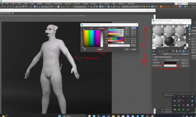

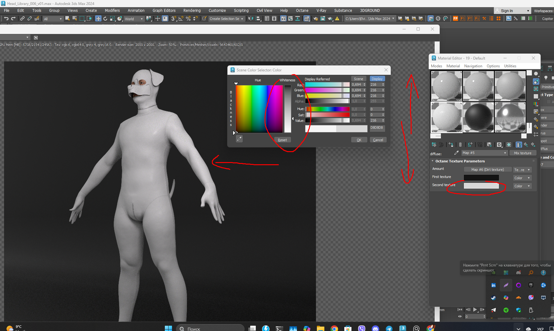

In OctaneRender® for 3ds Max® v2024.1.2 - 15.13, there are noticeable freezes during interactive rendering — even when adjusting a simple color, the slider moves with significant lag.
I suspect that this issue might also be present in newer versions. There’s a strong possibility that the problem is related to the NVIDIA driver. I don’t recall having such lags in the 2024 version. With about 90% certainty, I believe the issue is caused by the second-to-latest driver version.
GPU: RTX 4090, driver version 581.57.

Hi Elvissuperstar007,
Thank you for reporting this issue.
This will be fixed in the next releases.
Thanks.
