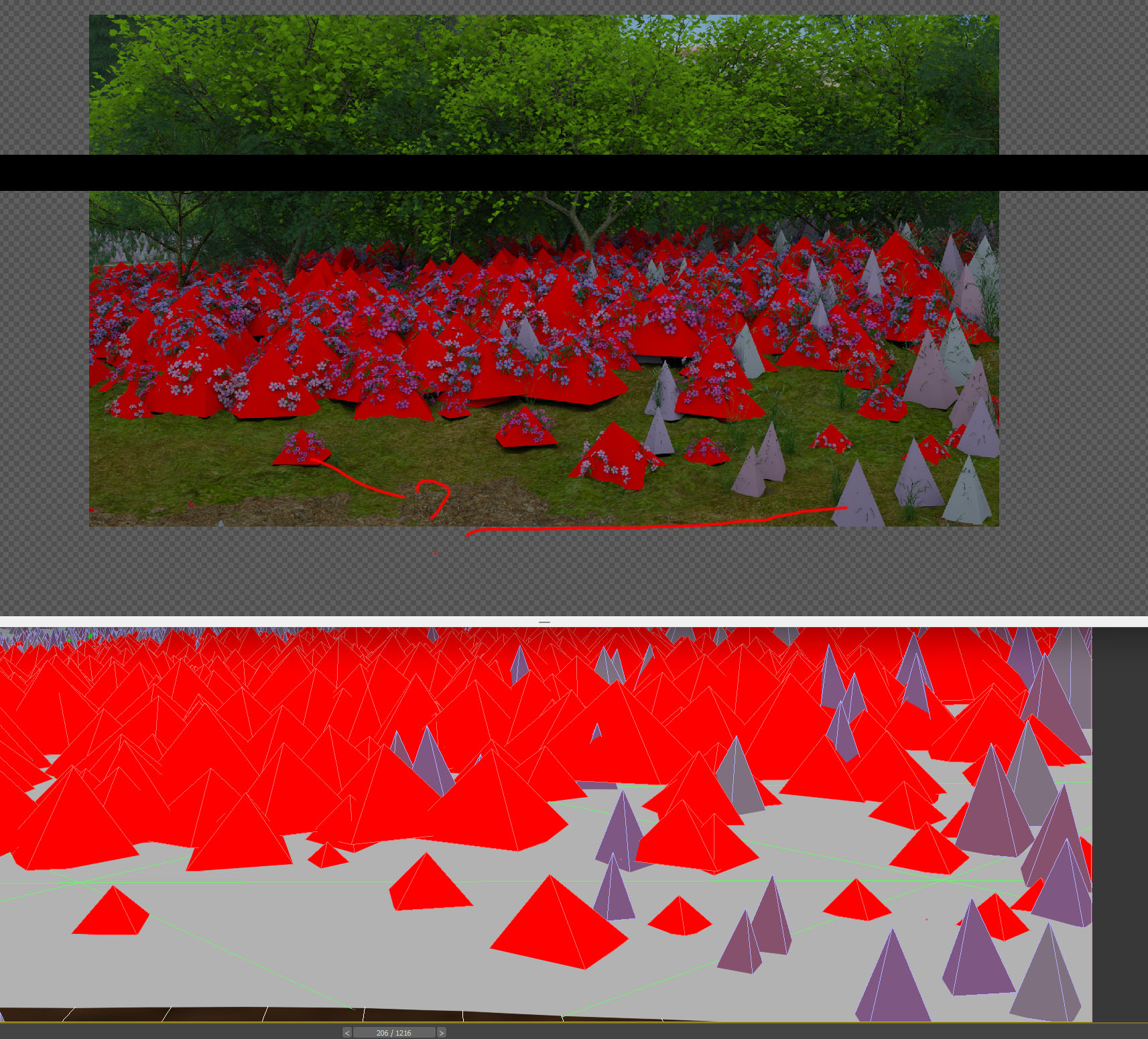

Hi coilbook,coilbook wrote: Wed Nov 05, 2025 6:31 pm Octane sometimes renders itoo display proxy as actual proxy and not mesh. Point cloud works fine especially when using legacy mode
Are you sure you set the mesh option correctly in the Display > Render panel in iToo?
Regards
Paride
