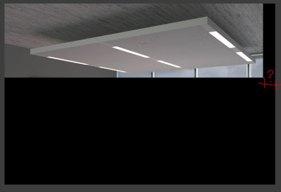

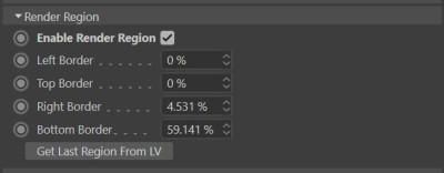

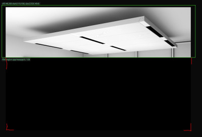

I found a problem when I select a region in LV for rendering, the right side of the region is not correct even if I go further on the right side, the "right edge" is set to 4.531% instead of 0%, so the final rendering is cut to that limit even if I see the region in LV is more further right of limit.
Another problem occurs when I start LV after creating a render scene on PV. almost immediately C4D crash. But if I select on LV "R" stop and reset the rendering data, this problem does not occur. This behavior does not occured during the previous versions.
And also I found that in LV the waiting time because the image appears is at least double that in the past.

thanks for the report about Render and Film Region.
It's a bug, and the Right border value is updated only if the new value is greater than the previous one.
So the workaround is to always reset the Right border value to zero, before creating and storing a new region.
