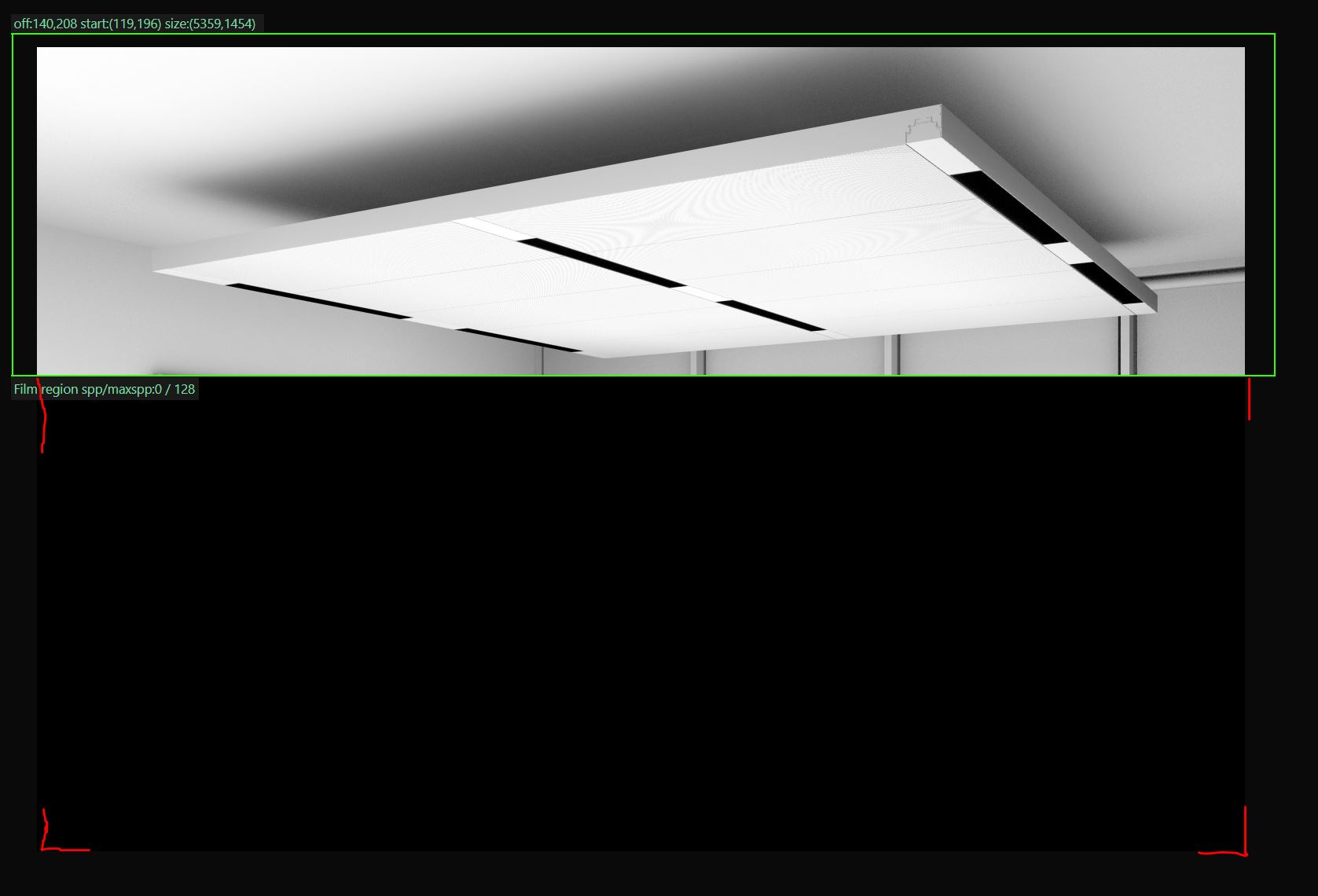

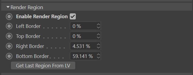

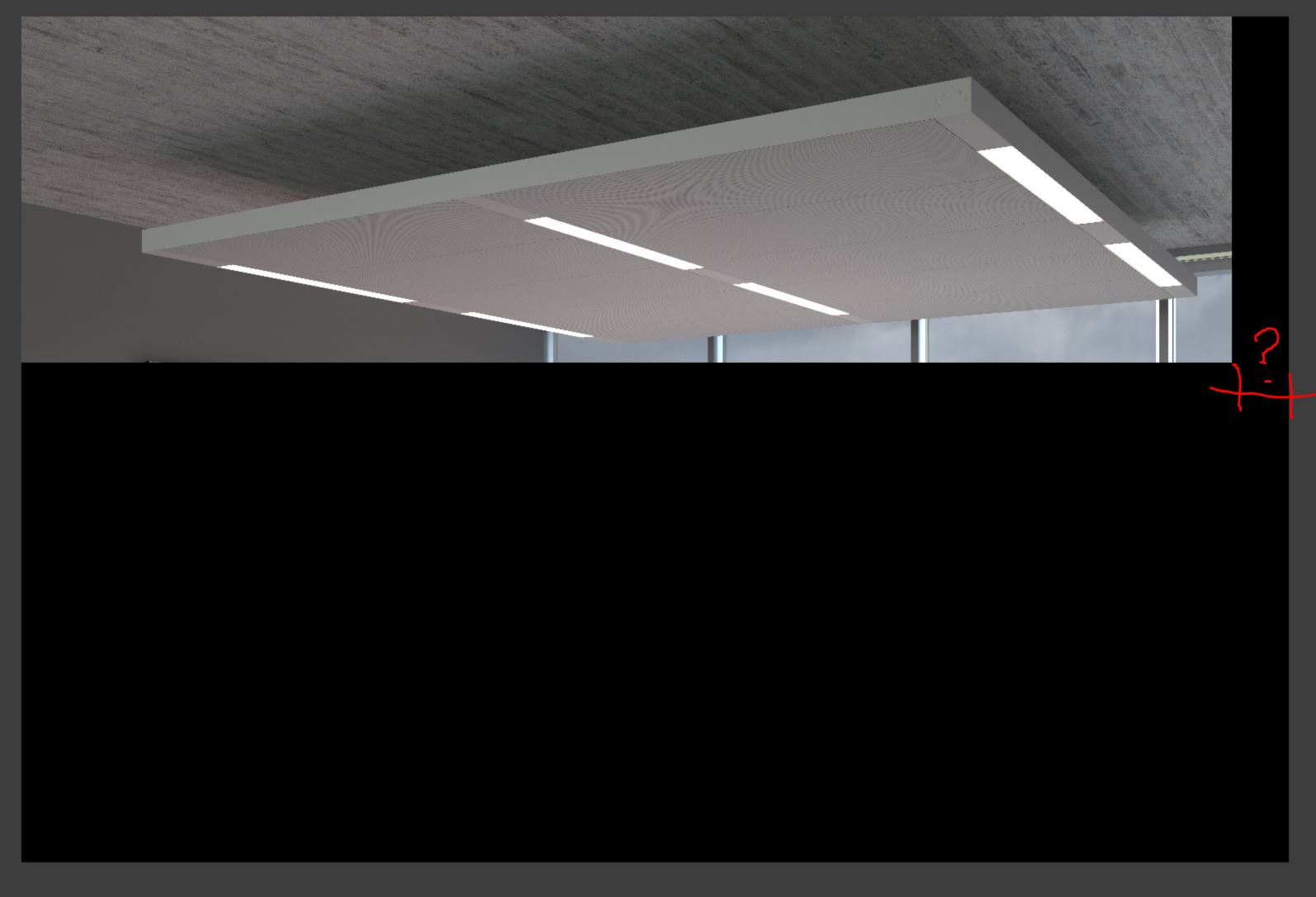

Hello,
I found a problem when I select a region in LV for rendering, the right side of the region is not correct even if I go further on the right side, the "right edge" is set to 4.531% instead of 0%, so the final rendering is cut to that limit even if I see the region in LV is more further right of limit.

thanks for the report about Render and Film Region.
It's a bug, and the Right border value is updated only if the new value is greater than the previous one.
So the workaround is to always reset the Right border value to zero, before creating and storing a new region.

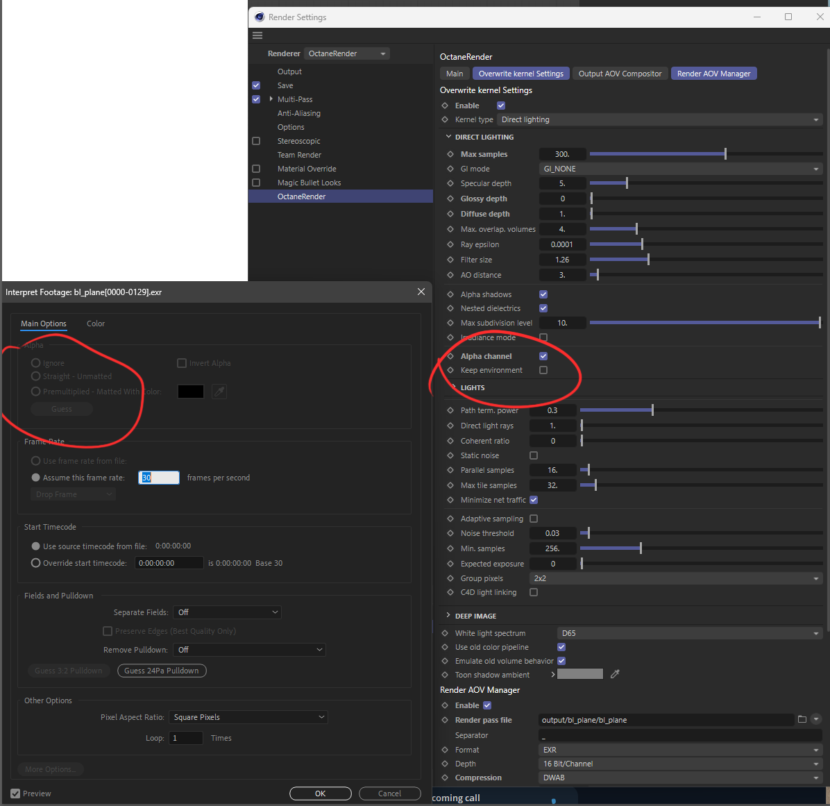

Hello!
What's going on with alpha channel?))
From v2024 may be, the alpha at beauty pass missed for a psd/tiff.... Now just rendered a sequence to exr via Octane render manager and there is no alpha at beauty)) Why?
+beauty just black... in Picture Viewer I see alpha, I see picture, opened in AE = no alpha + plain black images
upd.: Rerendered sequence to PNG have both alpha and picture with no problem...
sorry, my fault! The problem solved by just a bit of attention.
There was occasionally checked "multilayer file" option at AOV manager settings this time ((

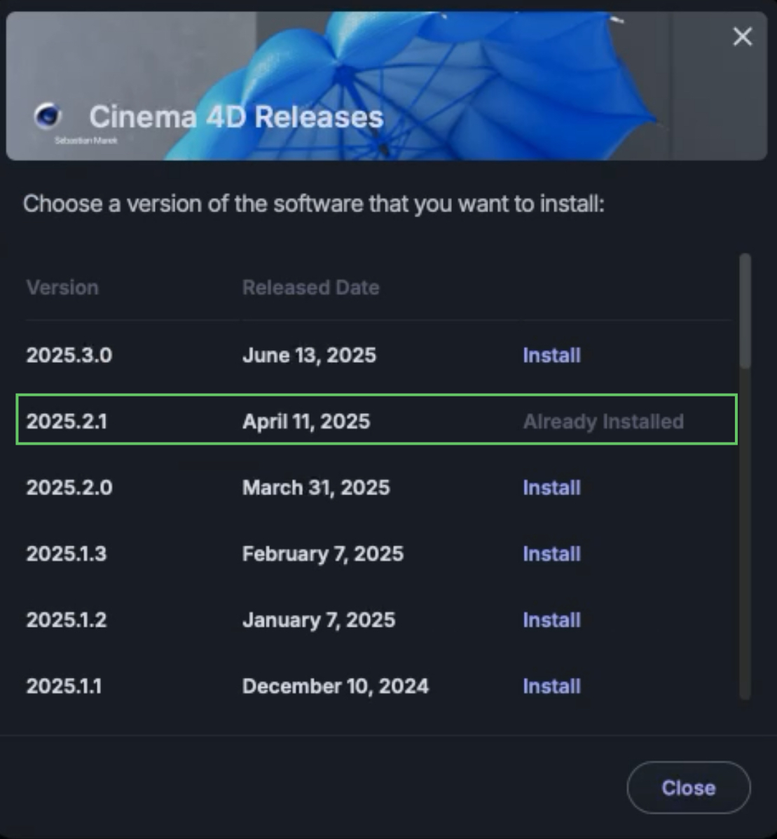

About Maxon C4d 2025.3.0 update issues, while we are investigating, please use the Maxon app to go back to 2025.2.1.

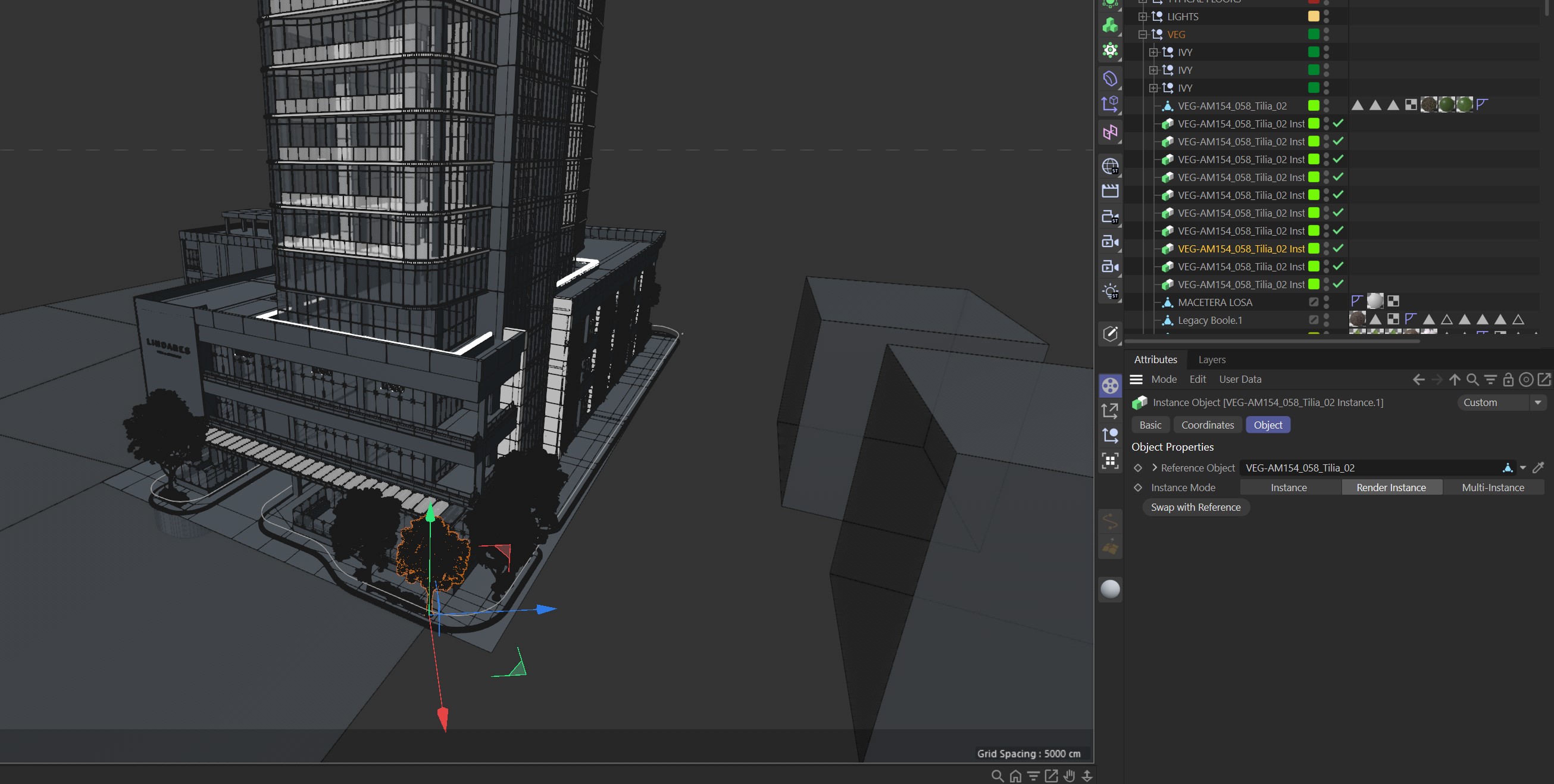

What could be the reason for rendering "Render Instances" in LiveView window but NOT showing in Production Picture Viewer?
It is an animation sequence.
EDIT: I see... I must set "all objects movable" in geometry control.
Wish Auto-detect solved this case.
Will need to read more about it.

We will soon deprecate all options other than "All Objects Movable"
