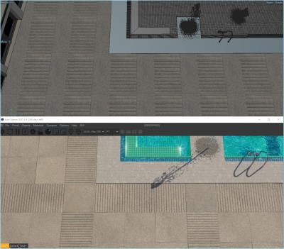

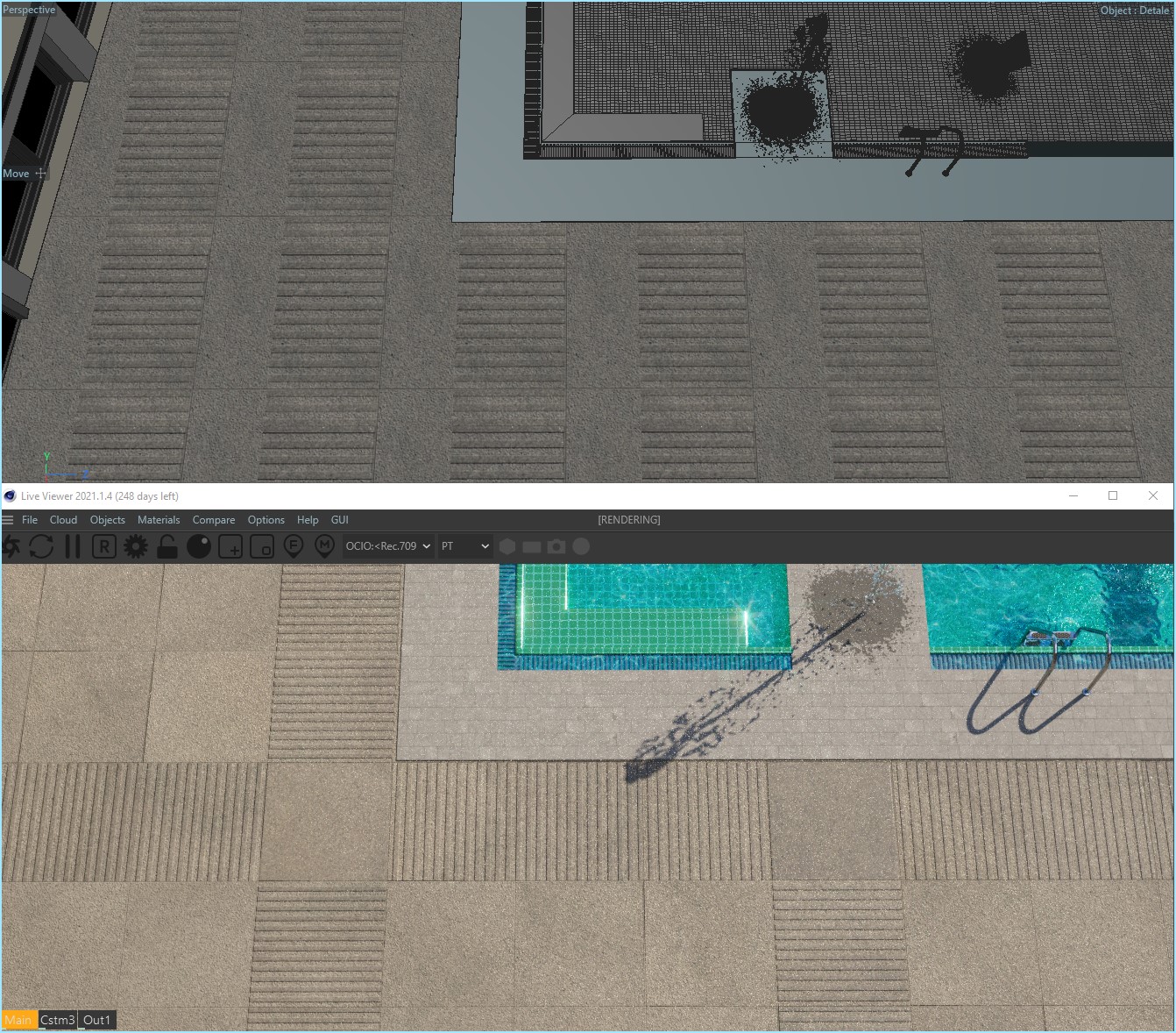

OGL texture preview in C4D viewport doesn't look the same as in LV. I tried different projections. Also Preview Size in Octane options works different that is described in manual - it control texture view in OGL viewport but by strange way.
Architectural Visualizations http://www.archviz-4d.studio
Posts: 16068
Location: Türkiye
SSmolak wrote:OGL texture preview in C4D viewport doesn't look the same as in LV. I tried different projections. Also Preview Size in Octane options works different that is described in manual - it control texture view in OGL viewport but by strange way.
Only uv mapping will give same results. Previews are like baking something in UV coordinate range of 0-1. Any other questions?

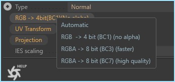

Sorry to bother you again but I found little issue with changing compression type of multiple selected textures in Octane Texture Manager. If one of them has different compression type this button to change them dissapear. Also changing multiple textures at once for example 10 cause that we have 10 times click on the same option.
Posts: 16068
Location: Türkiye
SSmolak wrote:Sorry to bother you again but I found little issue with changing compression type of multiple selected textures in Octane Texture Manager. If one of them has different compression type this button to change them dissapear. Also changing multiple textures at once for example 10 cause that we have 10 times click on the same option.
Yes it's like that because that's not a typical parameter.
