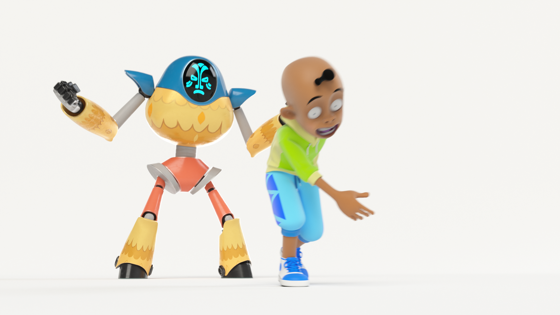

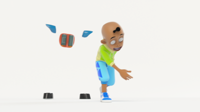

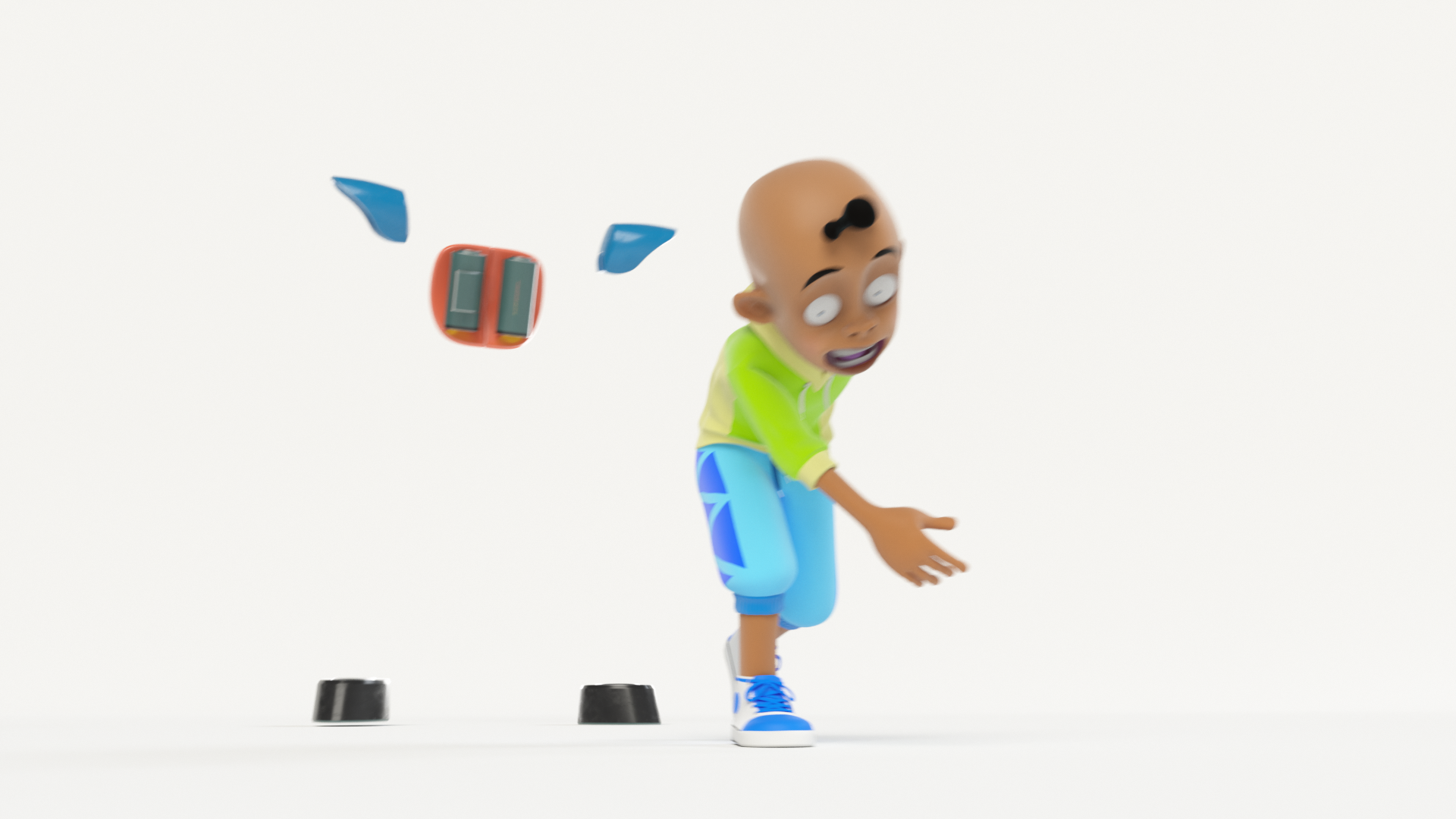

Hi Juanjo.
I'm working on a small animation and I'm getting some bugs when rendering sequences.
I send the link to a small rendered scene so Juanjo can see what's going on.
In this scene I had problems in frames 34, 42, 65, 80, 92, 94, 128, 145.
This happens whenever I render.
I've done many more animations and this has never happened before.
Thanks.
Carlos Caldeira.
Link for download: https://www.mediafire.com/file/7rxqgq63 ... G.zip/file

First off check your model for any polygons with more than 4 sides. NGons should really be avoided in character rigs, as when the plug-in triples them it could possibly change the ploy count thus the model gets dropped out.Carlos3D wrote:Hi Juanjo.

Try rendering without motion blur. Does this animation use bones or is the animation baked onto objects? What type of subdivision was used here - native or from Octane?

I have seen vanishing objects before, as I said check for ngons they can create all sorts of problems.
I had this job with lots of machines controlled by both morphs & bones. These were imported cad objects, some would just vanish from the render, turned out to be the ngons I had not removed or tripled. That scene had motion blur & a version without. The problem affected both.

This can also be a problem with the multi-thread scene extraction or with the scene updating. You could try to render your scene after disabling the muliti-thread scene extraction in the plugin options panel and/or render the scene in full scene reload mode.
