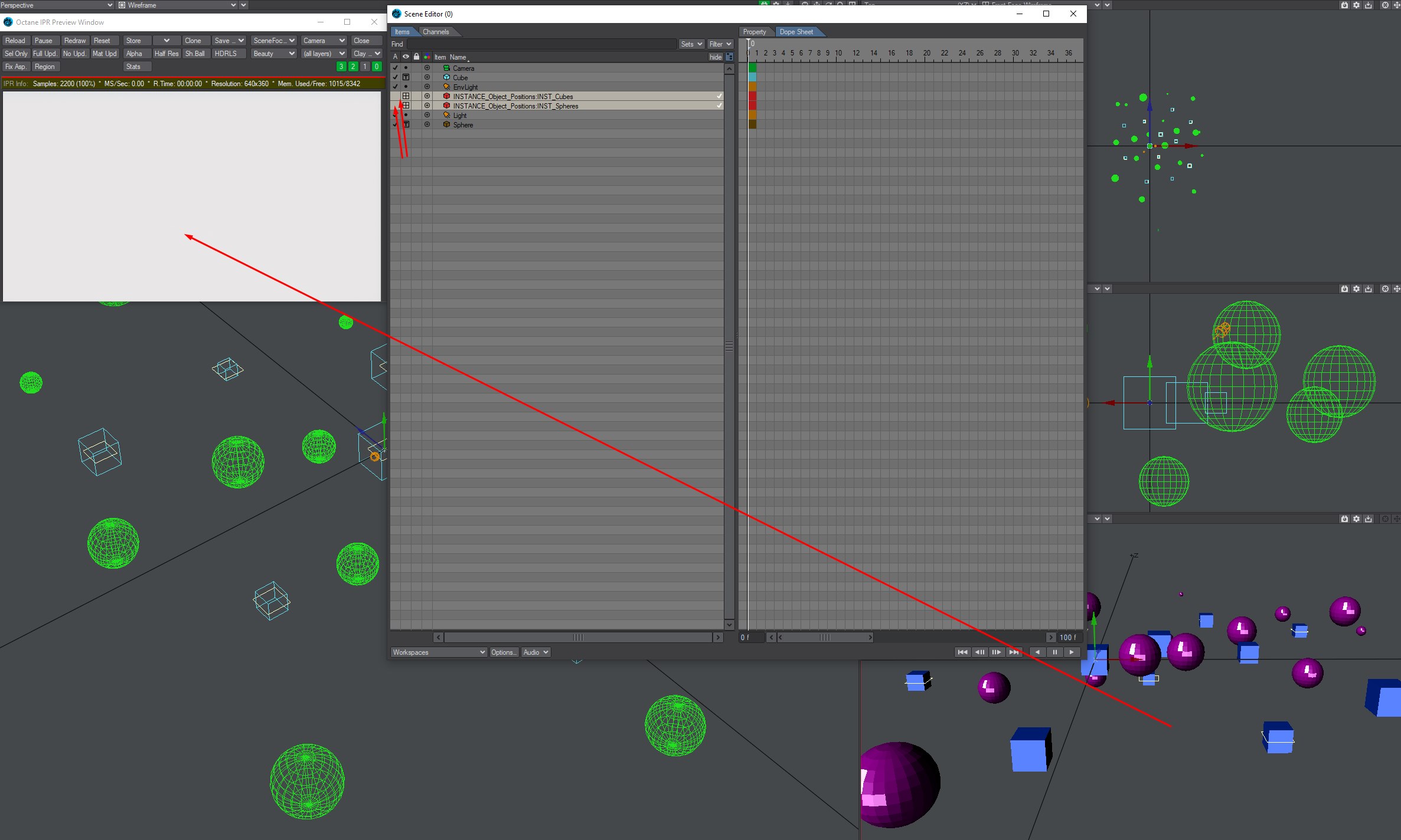

Hi Juan,
Sadly, this build now has a massive BUG. now, instances do not render unless you activate their instanced object/geometry.
See this scene (attached). I have cubes instanced per poly position and spheres per point. And IF that instanced geometry is OFF in Scene editor (as it should be since i don't want to render the basic planes) then Octane do not render instances either.
Please check this scene/render and fix it soon 'coz this way it's useless for scenes with a lot of cars/chairs/tables (all the stuff I use to orient instances on "short edge" and instanced geometry on polygons)...

Yes, do not render the instance in this scene.Lewis wrote:Hi Juan,
See this scene (attached). I have cubes instanced per poly position and spheres per pint. And IF that instanced geometry is OF Fin Scene editor (as it should be since i don't want to render the basic planes) then Octane do not render instances either.
I also see more VRAM consumption than in version 2.3.1

"Sadly, this build now has a massive BUG. now, instances do not render unless you activate their instanced object/geometry." - Lewis
As far as I know, that's always been the case in LW. That's one of the nice features I saw in Blender when I was doing the sprinkles in the "Donut" tutorial. You could hide the base geometry of the sprinkles and the instances would still show up. Instances don't work like that in LW, unless I'm missing something.
Yes, you misunderstood, it is broken in 2020.2.5.0 and useless for archviz now and it never worked like now. It always worked same (at least since Octane 2.0 when i started using it in Lw) till build 2020.2.4.0 and 2020.2.5.0 broken it.smount1 wrote:"Sadly, this build now has a massive BUG. now, instances do not render unless you activate their instanced object/geometry." - Lewis
I sent video and demo scene to Juan so hopefully fix is not long away.
R: Octane has always been like this in any version.
It shouldn't be an Octane issue but rather a LightWave limitation...
I believe!...
