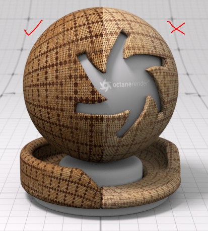

BUG: Chaos texture histogram invariant blending changes color of texture
1. Load the scene
2. Right click the chaos texture > render
3. Toggle histogram invariant blending on and off
RESULT: When "histogram invariant blending" is enabled, the color is a lot lighter, which is incorrect
1. Load the scene

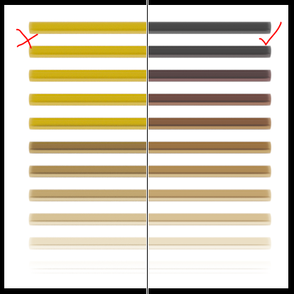

BUG: Hair material producing incorrect melanin colors with new color pipeline
Martimoo brought this up on discord.
1. Load the scene and render
2. Toggle kernel > "use old color pipeline" on and off to see the difference
With the old color pipeline, melanin becomes black at values close to 1. This is correct.
When the new color pipeline is used, melanin at 1.0 becomes yellow, which is incorrect
