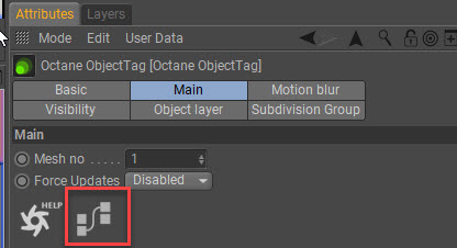

Hi, I cant see the octane object tag in the node editor. I have a tfd container, i select tag and nothing happens. Is that the case there too?
Posts: 16068
Location: Türkiye
thanulee wrote:Hi, I cant see the octane object tag in the node editor. I have a tfd container, i select tag and nothing happens. Is that the case there too?
try this button
