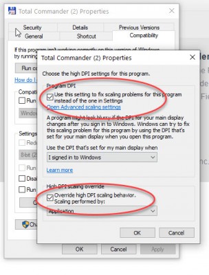

As said before no updates planned! Use %100 scale for resolution and adjust font sizes. Also you can use highdpi compatibility for softwares which don't support it.

I'm also working on 4K monitors and adjusted everything which can be readable by using the methods I wrote. Try to apply what I wrote, you can adopt all software to 4k by using the method in picture. Anyway I'll ask to Maxon if they have any advice.

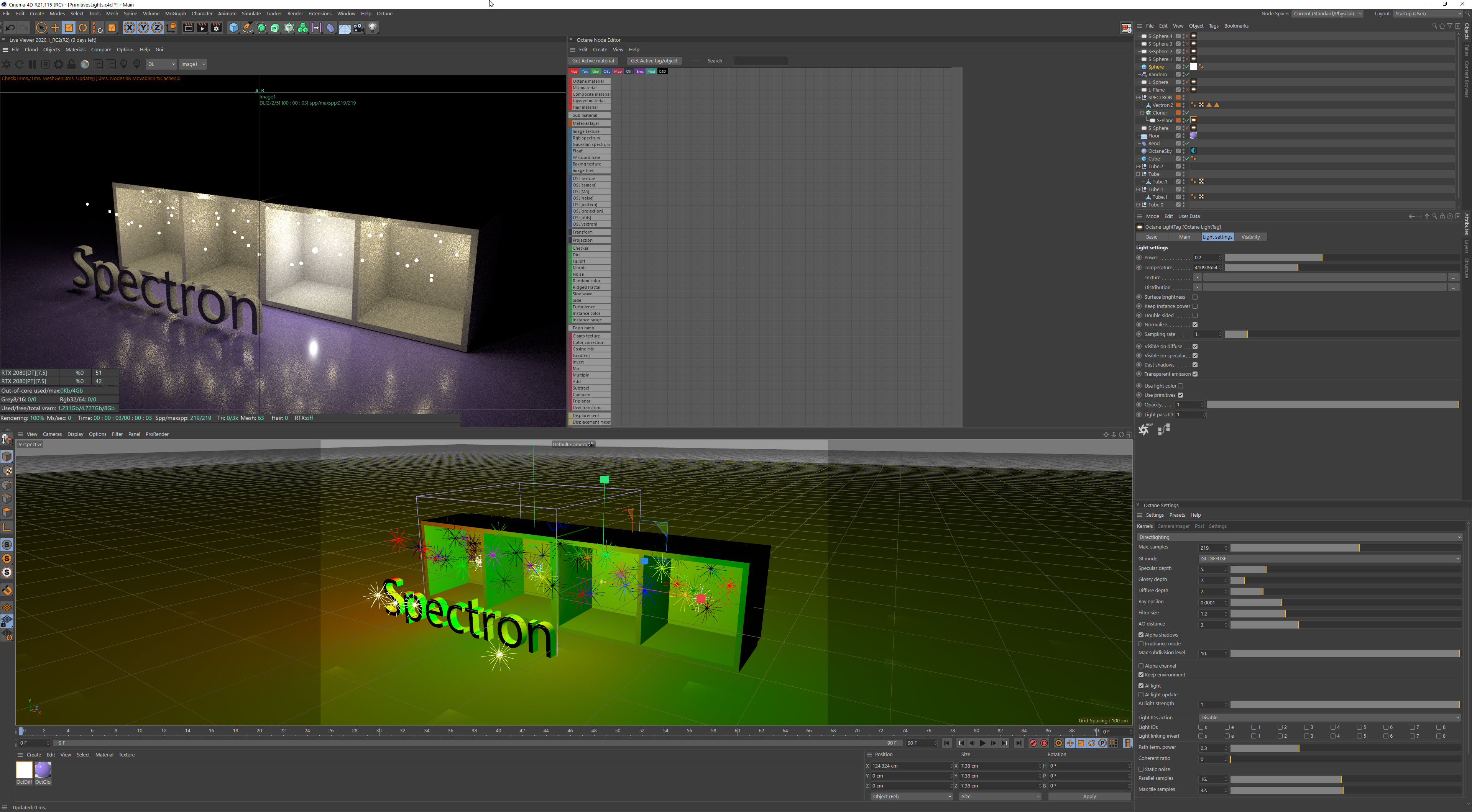

This is my c4d screen without blurry fonts and results at %100 zoom
