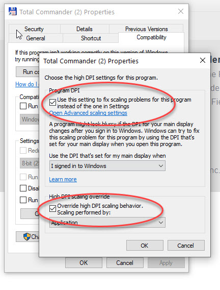

As said before no updates planned! Use %100 scale for resolution and adjust font sizes. Also you can use highdpi compatibility for softwares which don't support it.

This question sounds to me we don't believe you. High dpi support came with R21 and probably needs to adopt all functions in LiveViewer for a fake resolution to create an illusion. It's not easy for me even we can detect/find how to know the usage of high-dpi emulation in C4D. Because LV has many many extras as in-screen drawings and mouse handlings.,
I'm also working on 4K monitors and adjusted everything which can be readable by using the methods I wrote. Try to apply what I wrote, you can adopt all software to 4k by using the method in picture. Anyway I'll ask to Maxon if they have any advice.
This is my c4d screen without blurry fonts and results at %100 zoom
