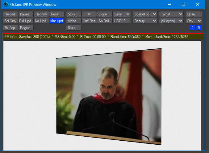

When I map a video it does not appear in my animated render.
The question is: Is it possible to map videos on Octane?
Thanks.
Lewis
Posts: 1115
Joined: Tue Feb 05, 2013 6:30 pm
Location: Croatia
Carlos3D wrote:When I map a video it does not appear in my animated render.
Thanks.
It should work (alhough it's better to have frames in general) just be sure you have Update materials ON

Carlos3D
Posts: 117
Joined: Thu Feb 26, 2015 5:45 pm
Thanks.
http://prntscr.com/qnh8ej
I already did it but unfortunately it doesn't work here on my Octane.

Lewis
Posts: 1115
Location: Croatia
Carlos3D wrote:
Thanks.
F9/F10 or IPR ? for IPR you need to have material button in IPR also.

juanjgon
Posts: 8867
Location: Spain
Hmm, I think that Octane doesn't support animated textures from video files. You need to convert them to image sequences and load the sequence from the LightWave image editor.
Thanks,
-Juanjo
Carlos3D
Posts: 117
juanjgon wrote:Hmm, I think that Octane doesn't support animated textures from video files. You need to convert them to image sequences and load the sequence from the LightWave image editor.
Thanks,
-Juanjo
Thank you very much Juanjo Ill do that right now.
Carlos3D
Posts: 117
Works perfectly, thank you very much Juanjo and Lewis...
