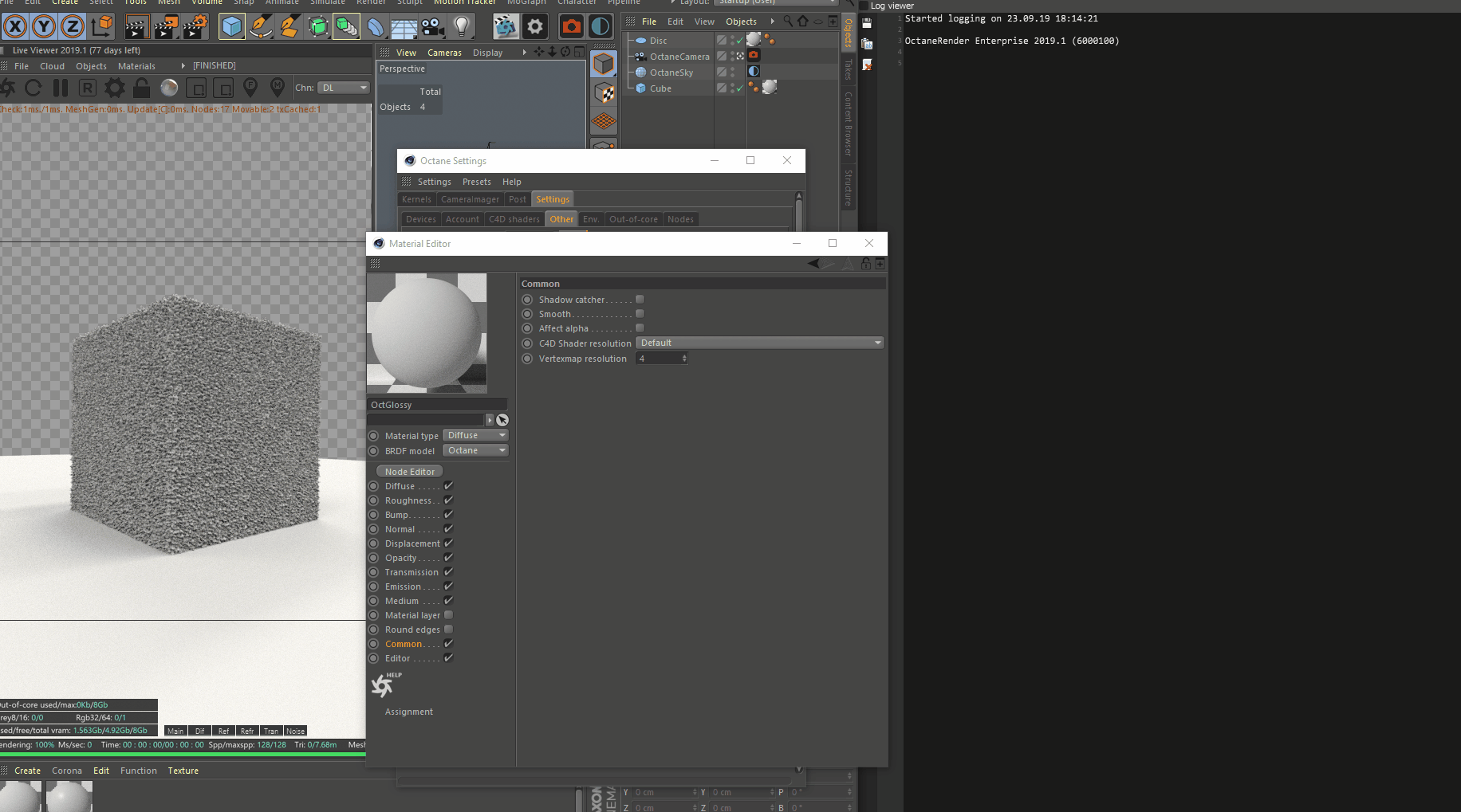

aoktar wrote:Ok, It's not a plugin issue. I've reported to Octane devs. Btw It doesn't happen one me, maybe you do something different. Or it's related with your hardware.
ok nice,
on the other hand I rematched that I have no error with the shadow catcher feature, when I use only the 2080ti by unchecking the 3 1080ti.
Maybe this is due to the mix of different hardwares?
What is curious is that this does not happen in the standalone or in the previous version 2019.1 of the c4d plugin?

I cannot know, it's renderer related under hood. We only do connection between host and core. Rest is up to renderer.

I got the very same issue. Windows 10, 64, Driver 431.86, 3xGTX 1080, R20. Shadow catcher crashes Octnae in C4D.
Standalone works flawlessly.

Kalua wrote: I got the very same issue. Windows 10, 64, Driver 431.86, 3xGTX 1080, R20. Shadow catcher crashes Octnae in C4D.
Standalone may work flawlessly that doesn't mean SDK doesn't have problems. When we use the Renderer in a host there's extra factors to cause problems. For example; material previews or Host software's Opengl/Gpu usages.
Make a test without octane previews are enabled or with software opengl.

Hi and thanks,
it works by disabling the materials preview. :D
Overview in the material manager remains grayed.
on the other hand when I test only with the 2080ti, everything works even with the feature "material preview" enabled,
but the preview becomes black, which is not a normal behavior compared to the old version where the preview remained white?
