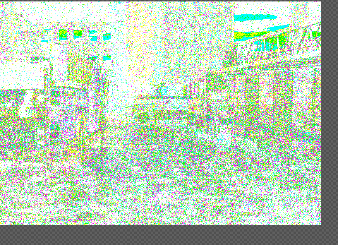

Why I am getting this strange image in this version. It starts out ok then all white. It happens when using slaves. it's like lights start glowing 100s times brighter octane 4.04 doesnt have this problem
it is similar to this but it happens with all kernels as soon as you enable slaves/ Our slaves are 2080tis and titan pascals mix viewtopic.php?f=9&t=55380&p=283639&hili ... es#p283639

when using network renderer image turns to strange colors. no up-sampling is used I attached the video
do you know when this will be fixed. We cannot use 2019.1 because of it and cannot go back to 2018.1 because we created textures in 2019 and now a lot of textures are messed up in 2018 (no image bitmaps showing up, missing paths, different brightness) In 2019.2 xb3 is even worse the sun doen't work and crashes with rtx.
also in new version octane viewport got so slow you cannot even move around in 3ds max and see result in octane viewport it is so slow. octane 4 never had this problem
