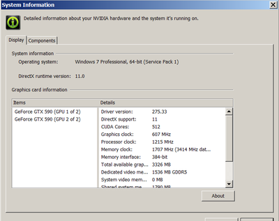

so that means that the card is instaled properly ,why is octane not showing two cards ?

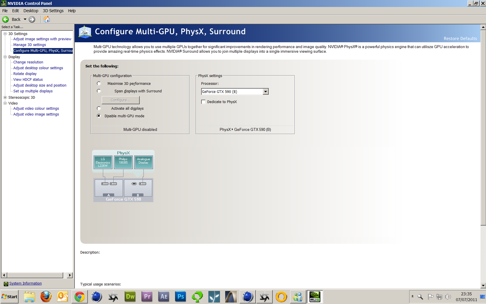

i think you must disable physics for both gpu in order to use all in octane :roll:

Physics is off. i will try now to install the card on my second workstation and see what happend ,

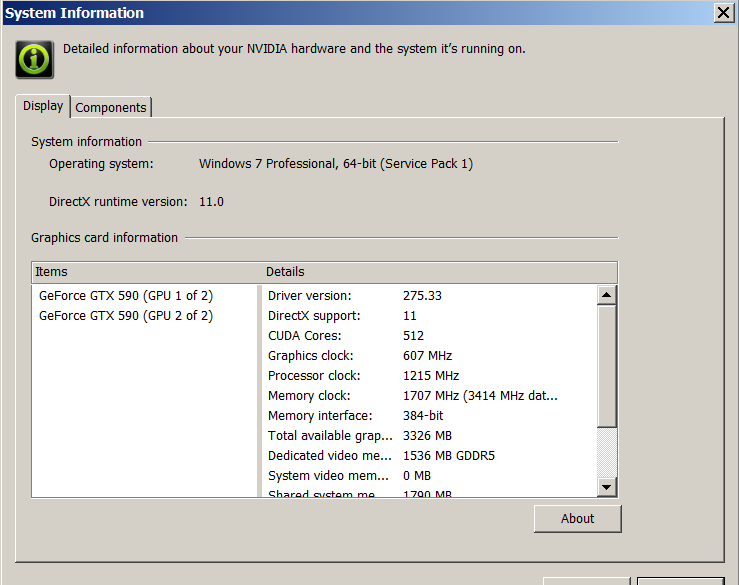

Please Rico, can you post the screenshot of the nvidia contropanel of the new machine?
my gtx 590 is just arrived and I'm in your previous condition, only 512 cores are seen :(

ribrahomedesign wrote:Hi beppe
i still dont know what the problem was with my older machine.
This is how it was supposed to look like. I wonder about same thing, the issue with your other machine...perhaps lack of SLI capability of the mobo?
