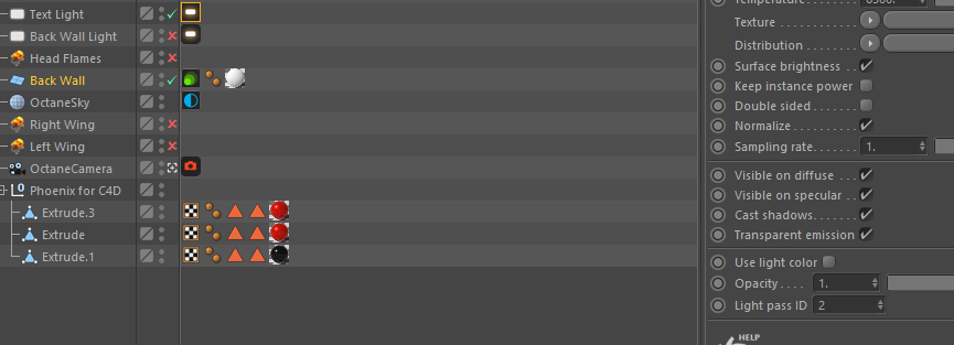

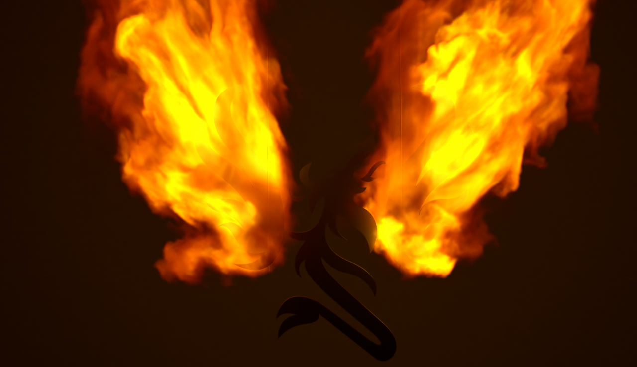

Here we go! Happening again. This worked when I swapped out for the 4.01.1 R2 plugin. It does not appear to work in 2018 RC1. I turned off all of the other lights in the scene.
The light is not supposed to hit the back wall. Just the text and logo.

Posts: 16067
Location: Türkiye
bagel wrote:Here we go! Happening again. This worked when I swapped out for the 4.01.1 R2 plugin. It does not appear to work in 2018 RC1. I turned off all of the other lights in the scene.
More critical info:
Cinema 4D R20.030
Octane C4D Plugin 2018.1-RC1
Windows 10
Pile of 1080Ti's
First be sure that's not a mistake on your side. And pls send me a scene if you have it reproducible.

aoktar,
I discovered something while I was packing up my scene to send it to you.. I was using an 8k image based texture channeled into a glossy material for my back wall (the object I wanted excluded from illumination of that one light. I didn't necessarily want to include the huge png files so when I took the material off the back wall plane, light linking started to work. Is there something special we have to do to octane materials for light linking to work? I tested several times adding and removing the material with the IPR running and it would, respectively, illuminate the back wall plane when the material was added. But it seems like it's just this one material (node graph below). Other base/procedural materials work fine with light linking. Testing diffuse, glossy, universal and metallic and all work. But this glossy mat with image textures in the graph is ignored. Could it be an issue with image textures?
I'll PM you the project file. Thanks for taking a look at it.
bagel
Posts: 44
Joined: Tue Jan 23, 2018 3:38 pm
It's displacement that breaks light linking. I just testing a new scene, 1 light, two objects. The second I attach an image texture to a displacement, image linking stops working.
