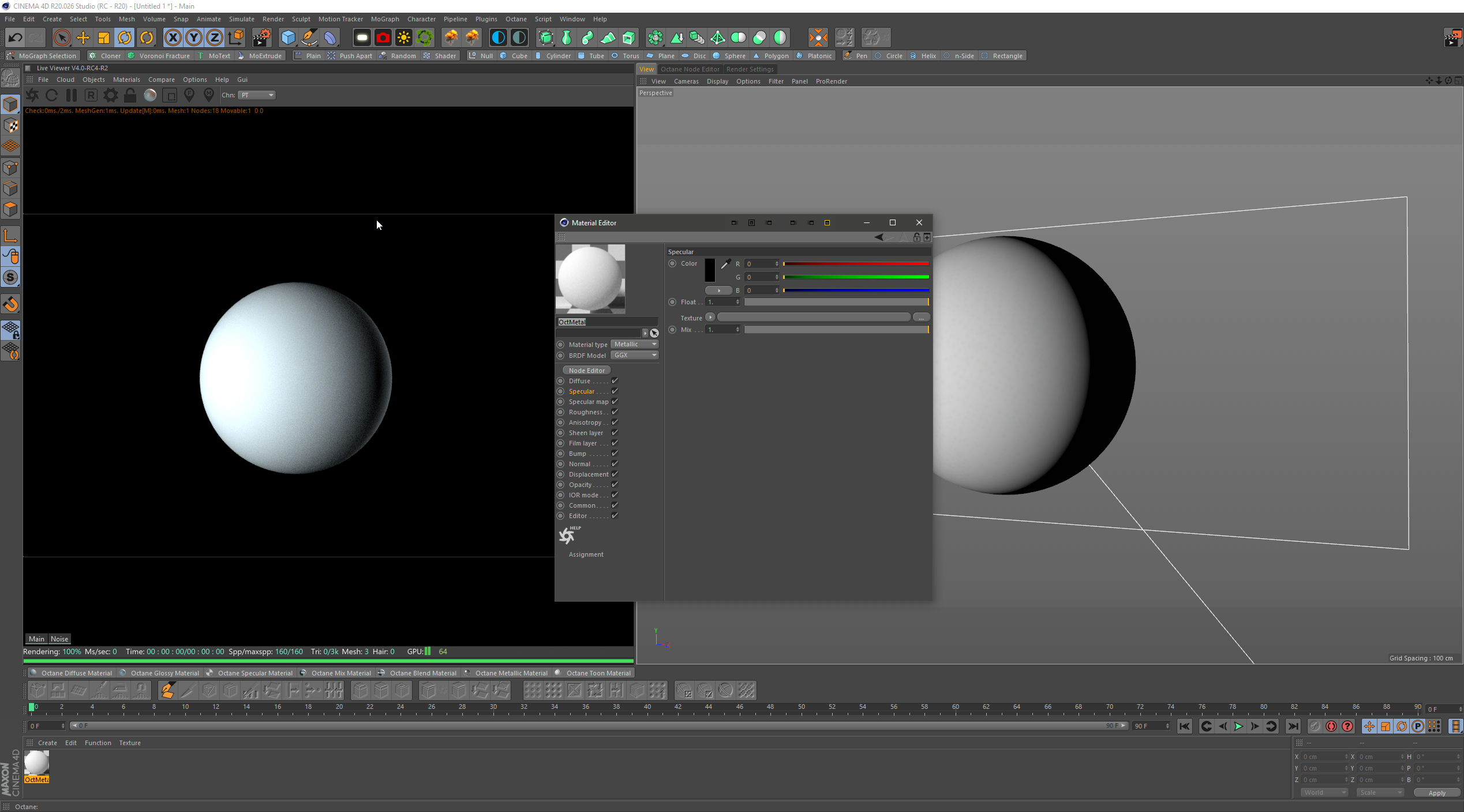

VVG wrote:does not save settings env when restart render or change kernel DL/PT. Always white
R19 and r20
As I wrote It's not a global parameter anymore. It will save the value to scenes and load back. It's done to avoid problems on deadline/network rendering/etc..
explain how to work with it?
how to make you Always be a black environment?
on video is this a normal work?
Wait, there's a problem on this parameter. Btw why don't use an environment object?

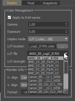

please, add drop-down menu for the folder with LUT (in camera tag/ pref)

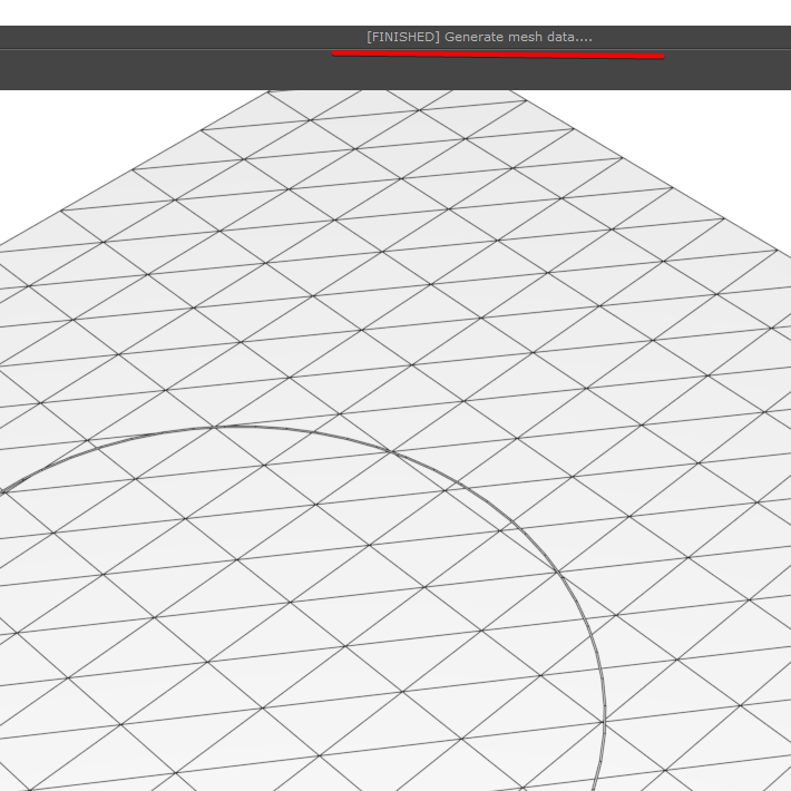

also still present in this version:
- draw a spline
- add oct-object tag to it and activate "render as hair"
- move around spline-object - > live viewer does not update
- move around a vertex of this spline-object - > live viewer does update
bonus:
- still no emission material for hair rendering
win7prof. | i7 4930, 32gb | 2*980ti 6g for renderings | 1*660 for displays
VVG
Posts: 301
Joined: Sat May 07, 2016 2:34 pm
mesut wrote:
aoktar wrote:... Please try with updated version!
- draw a spline
confirm (generate Mesh data....)
