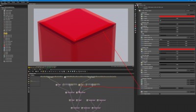

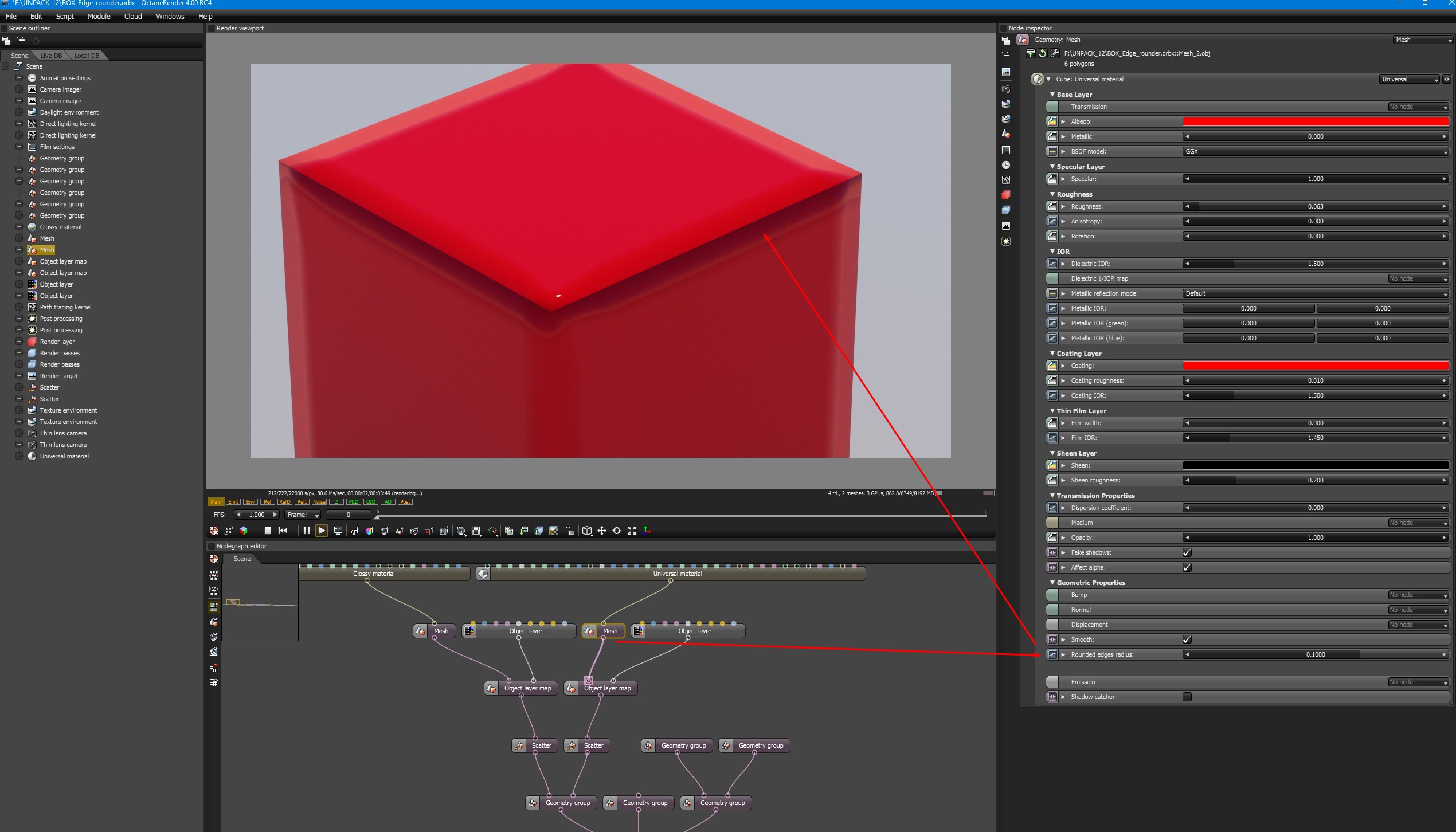

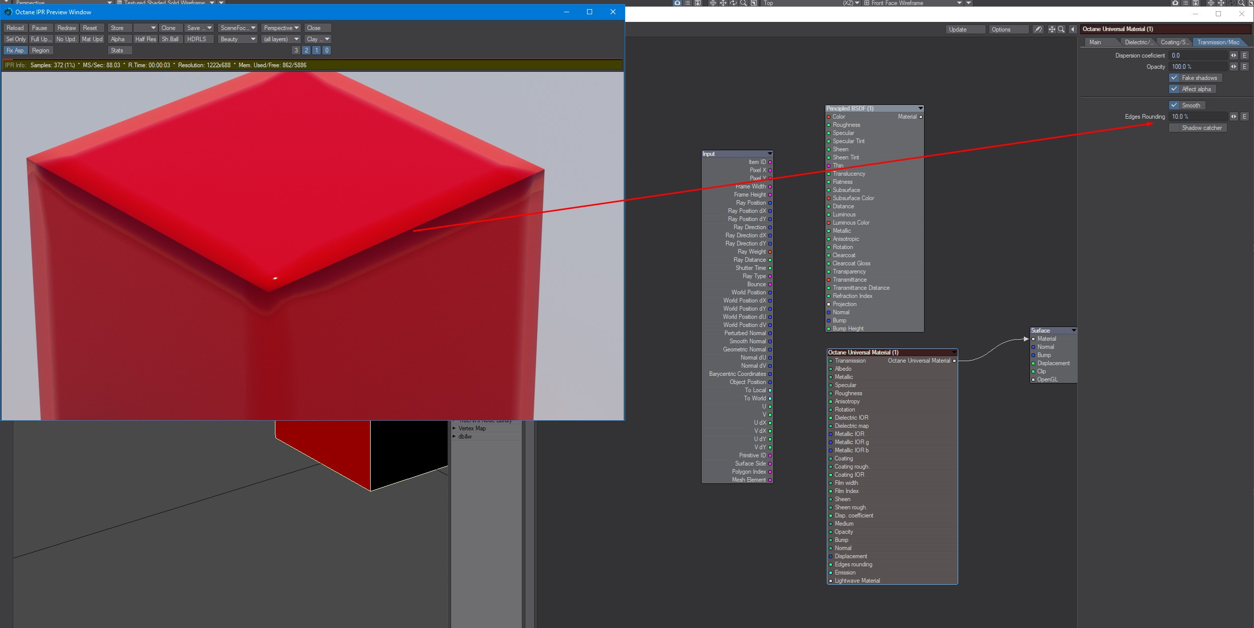

Hi guys,
Is there anyone who can show me what i'm doing wrong. I can't get ANY meaningful rounding of edges out of octane. Maybe i remembered wrong but i seem to remember that you guys said more work on that feature in post 3.08 and especially in 4.0 will be done but i still get same "nothing" good out of rounding. My simple 6 sided BOX is fully sharp on edges and i just get bad shading no matter which percentage (or float) i use :(.
I tried in LW plugin an din Standalone and it looks same/bad so i suppose it's Octane CORE issue ? Or this is broken now in 4.0 RC4 ?

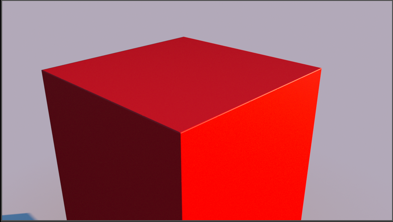

I'm not sure what you are expecting, but I think of the edge radius option as a "just break the sharp corners" tool, not a true rounding/modeling tool. For instance, a radius of 1 cm on a 200 cm cube works fine. I use it all the time, but I don't expect more from it than this:

Lewis wrote:hmm, can you show me your geometry how many sides/polys your box have ?
I can't get anything similar, can you maybe save ORBX and upload so i can examine your settings ?

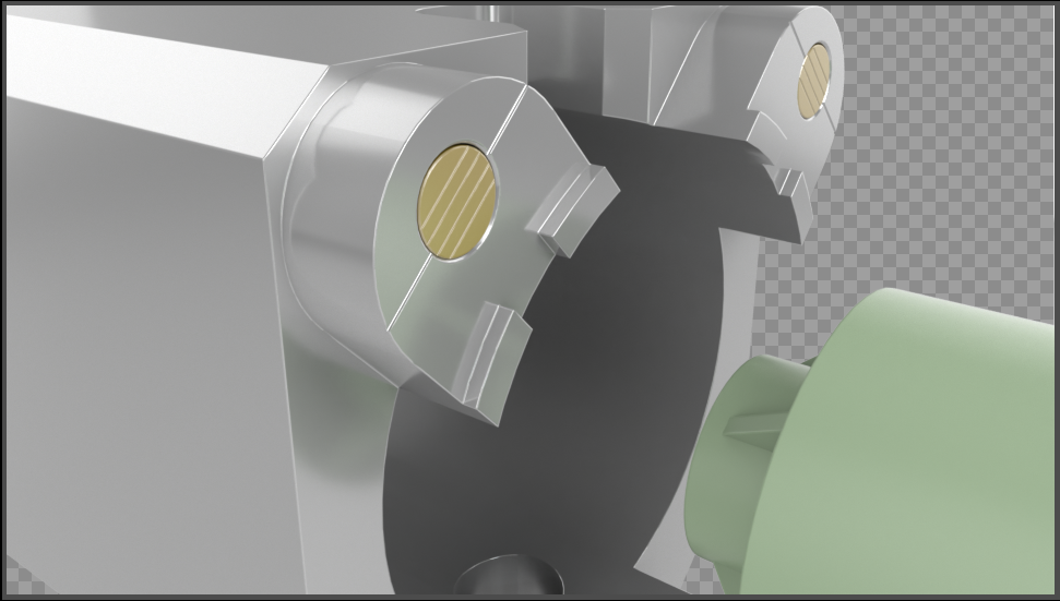

Sure thing. The sample .orbx is very simple, single poly per face geometry. Edges made from lots of poly segments will definitely show specular artifacts when the rounding number is greater than, "just break the edge". Here's a shot of the kind of thing I use it for in real life: breaking the edges of small machine parts and such. It's definitely not perfect. For high res still images I'd still model in the tiny bevels/radii, but for animations, the material edge rounding is good enough. Unfortunately, I can't upload the source file for that, but it's the same basic setup.
Edgebreaking
Edgebreaking
RoundCorners.orbx
simple cubes with edge rounding in shader
(66.04 KiB) Downloaded 283 times
