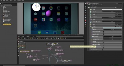

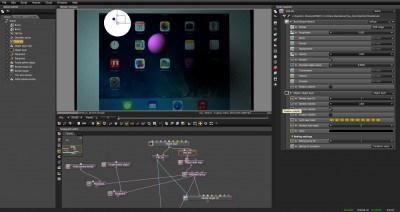

Had this happen in a scene so made this test scene to show.
Test Scene has:
1 Sphere Emitter (White)
1 Sphere Object (Purple)
1 Object Background (iPad)
GOAL - I want to have the background iPad receive no shadow from the Purple sphere blocking the White emitter sphere.
1) In Object Layer Node for iPad background, checking/unchecking the check box for Shadow Visibility does not have any effect....the iPad always gets a shadow from the Purple Sphere blocking the white emitter sphere.
I do not want this. 2) In Emission-Visibility for the emitter sphere, I can uncheck 'Cast Shadows', and this causes no shadow to be produced on the background iPad, which is what I want So I find that Object Layer's Shadow Visibility checkbox does not do anything.
Possible bug?
Thx.

To kill the shadow coming from the purple sphere you need to add a "Object Layer Map" to it.Notiusweb wrote: GOAL - I want to have the background iPad receive no shadow from the Purple sphere blocking the White emitter sphere.
