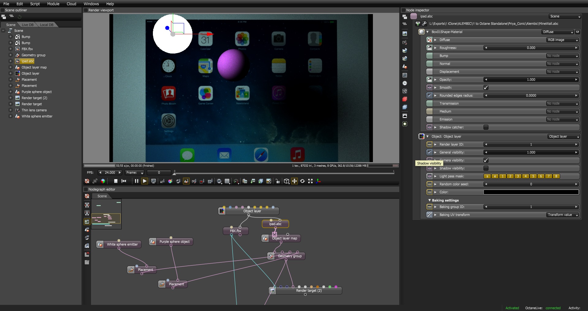

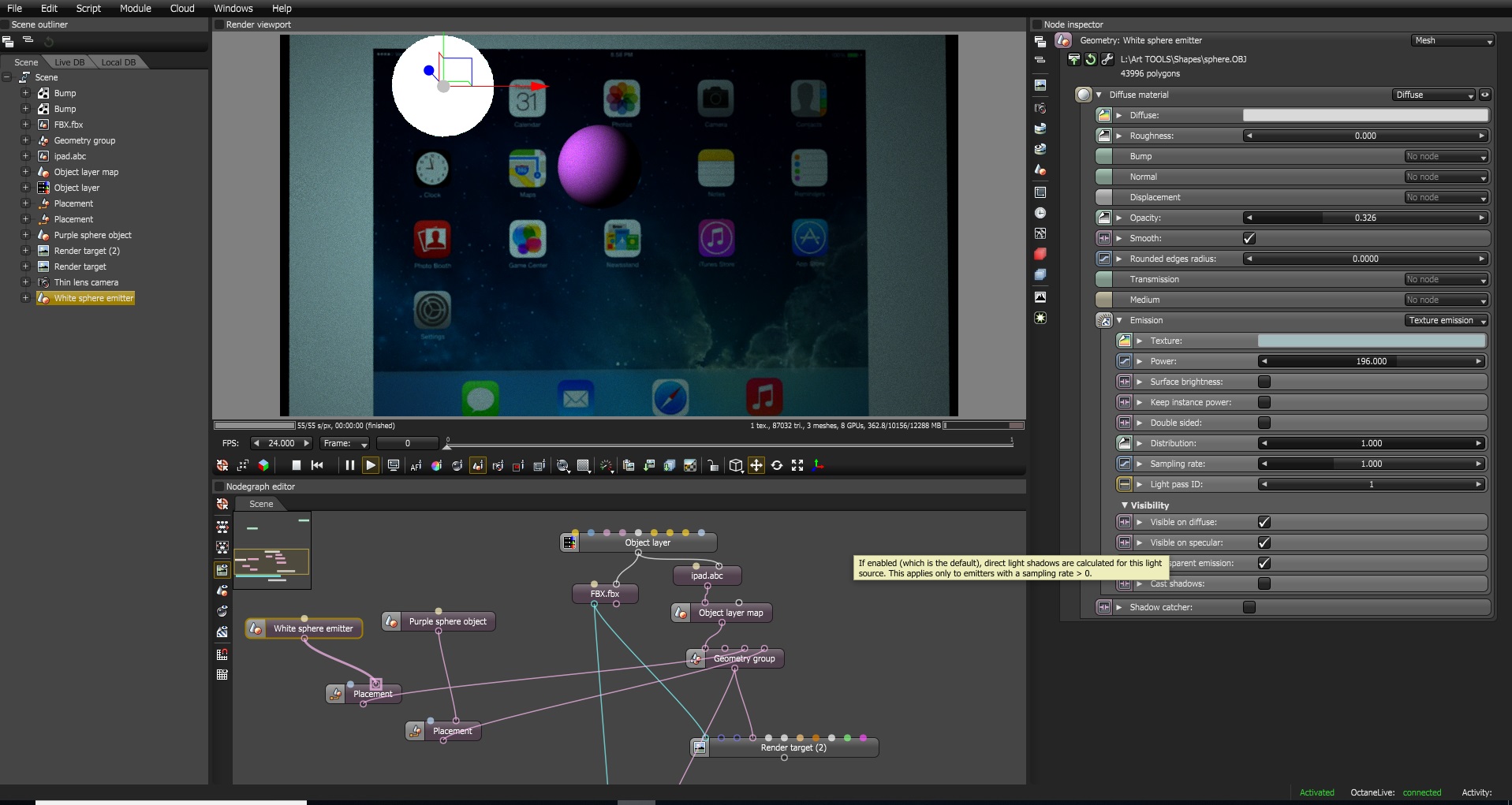

Had this happen in a scene so made this test scene to show.
Test Scene has:
1 Sphere Emitter (White)
1 Sphere Object (Purple)
1 Object Background (iPad)
GOAL - I want to have the background iPad receive no shadow from the Purple sphere blocking the White emitter sphere.
1) In Object Layer Node for iPad background, checking/unchecking the check box for Shadow Visibility does not have any effect....the iPad always gets a shadow from the Purple Sphere blocking the white emitter sphere.
I do not want this.
2) In Emission-Visibility for the emitter sphere, I can uncheck 'Cast Shadows', and this causes no shadow to be produced on the background iPad, which is what I want
So I find that Object Layer's Shadow Visibility checkbox does not do anything.
Possible bug?
Thx.

Notiusweb wrote: GOAL - I want to have the background iPad receive no shadow from the Purple sphere blocking the White emitter sphere.
To kill the shadow coming from the purple sphere you need to add a "Object Layer Map" to it.
