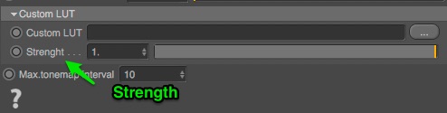

niestudio
Posts: 265
Joined: Fri Aug 21, 2015 10:03 pm
typo in the camera tag custom LUT section

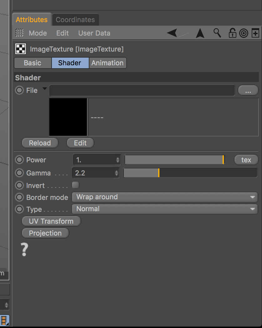

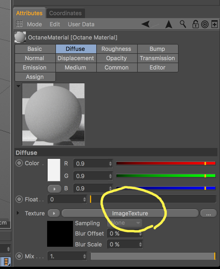

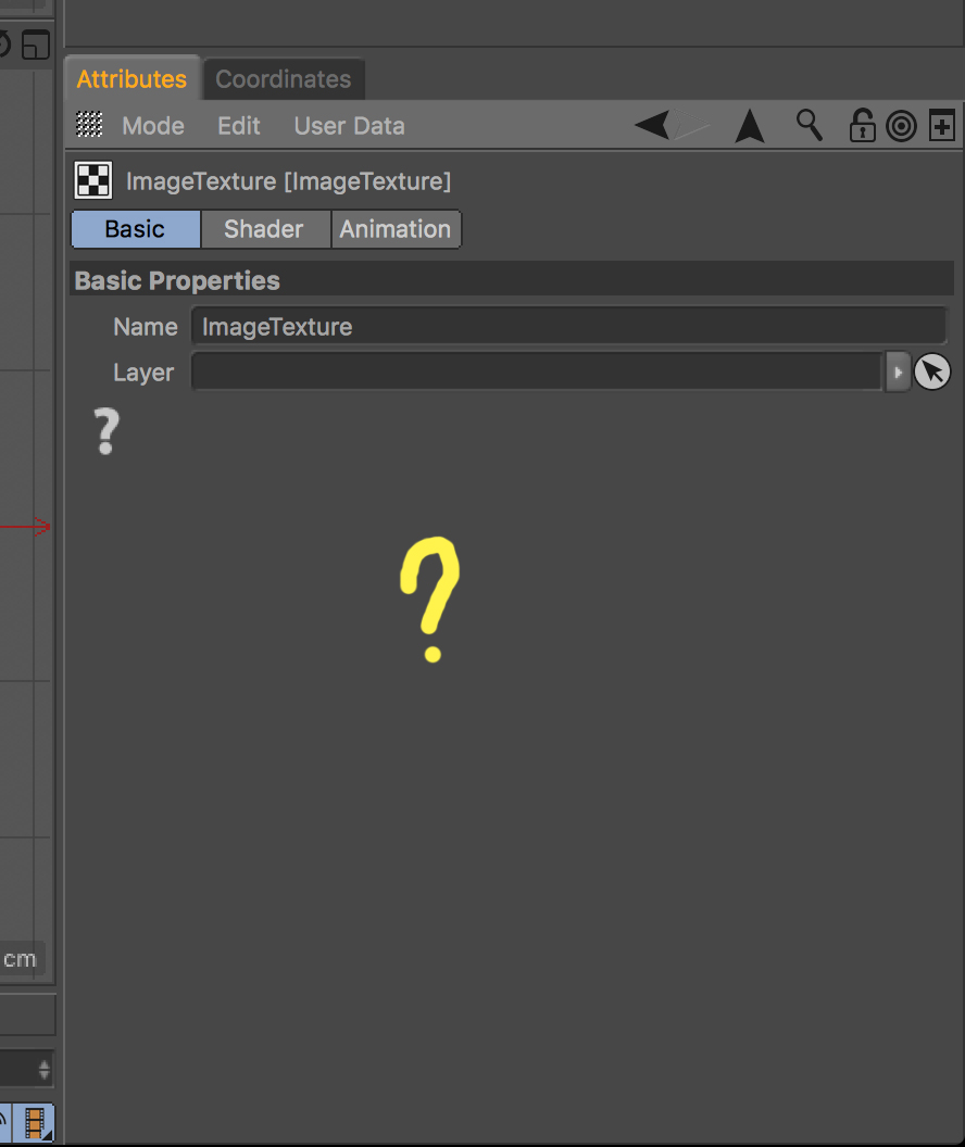

Hi Ahmet!
So, 3.08 is here!
Maybe I'm wrong, but clicking on button (Image texture)
to load a map, I get this:
Instead, as always, this
The same, the others channel...
Thank you
L.
