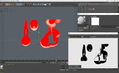

I'm reporting a similar issue with vertex maps.
Windows 10, Octane 4.04-R2
Mesh generators cannot translate the vertex maps for color/velocity, I've tried it with OVDB Mesher from X-Particles.
The data is all there when using the standard Renderer or other 3rd Party renderers, but the Vertex map glitches out with Octane.
I see this is an old issue, is there any workaround or hopefully a fix being developed?
Posts: 16067
Location: Türkiye
MediaMonsters wrote:Hi Aoktar

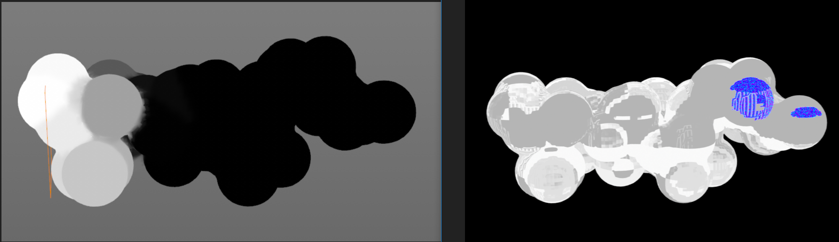

Here is a sample scene attached as well as two images showing the difference between the vertex map information on the vertex tag (seen on the viewport) and the actual way the information rendered out with Octane.
.C4D IS NOT A VALID ATTACHMENT - here is a link to the scene file:
https://www.dropbox.com/s/c24dyhwfn8n60 ... h.c4d?dl=0
Vertex Map comparison:

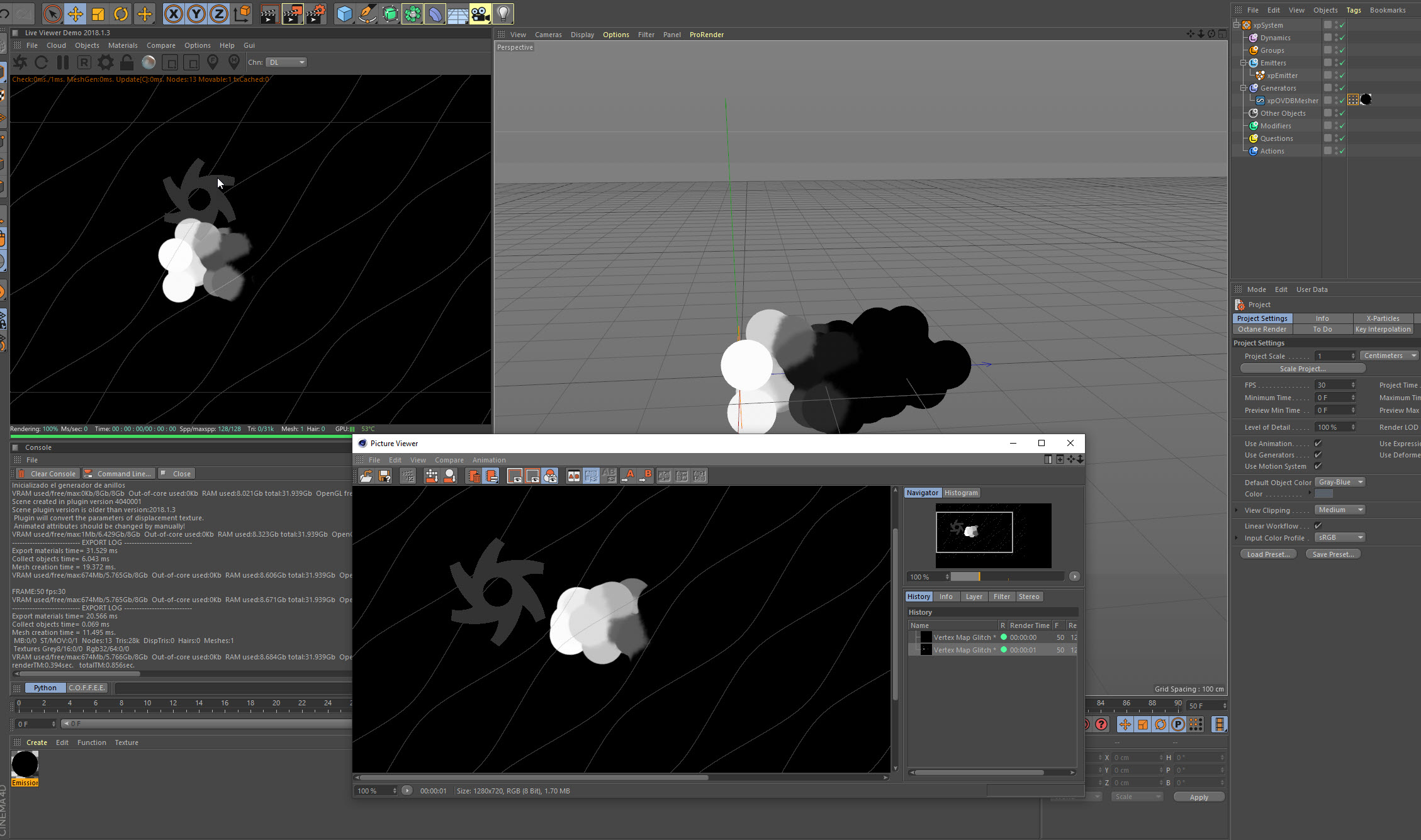

Posts: 16067
Location: Türkiye
It works as expected on me. What's your version? I think V4.
It looks like V4 glitches it because of hacked ways for Vertexmaps. But 2018 is using the new vertex attributes feature and works flawlessly.
