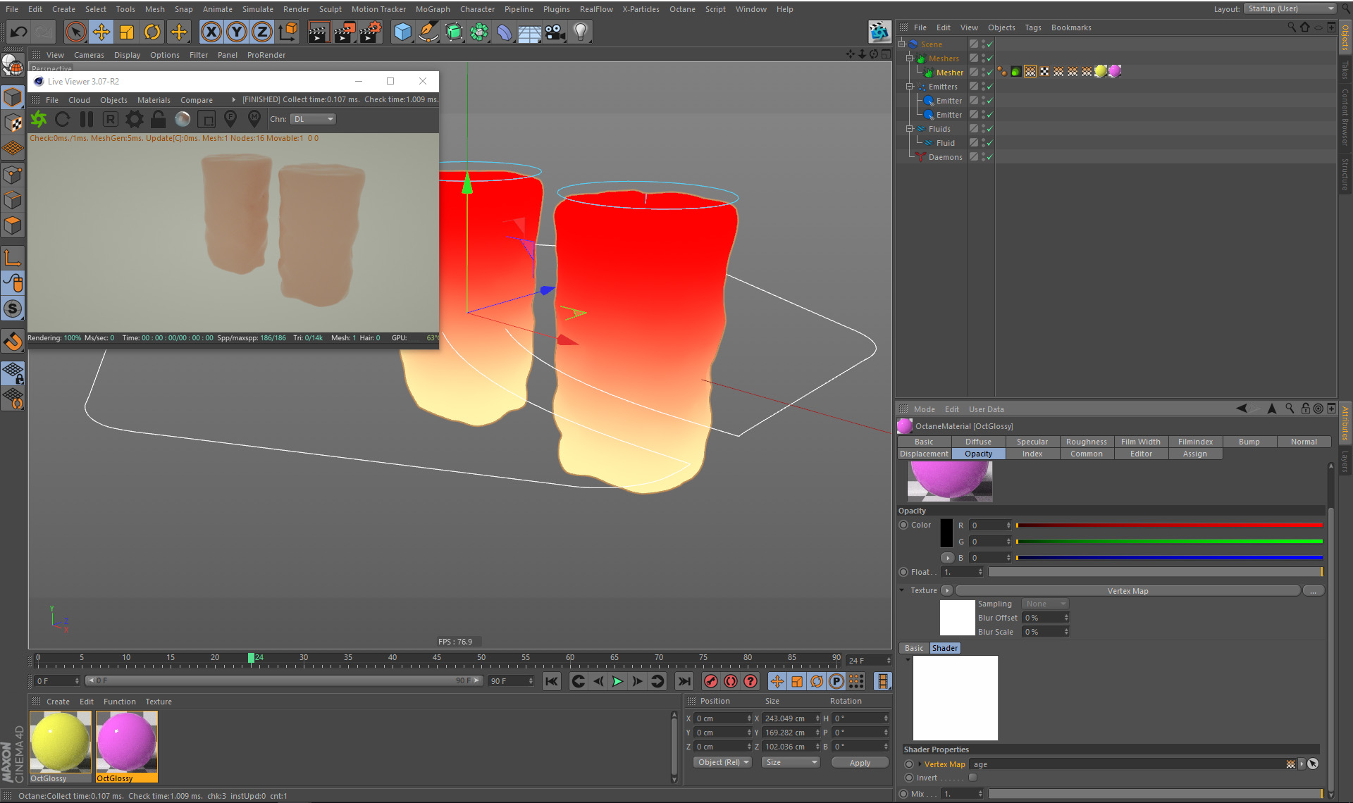

Hi Ahmet,
I've just got Real Flow 2.5 and I can't seem to make the new Vertex Maps Channels working, quite weird as Octane "sees" VM in all other cases.
I've followed this procedure:
https://youtu.be/VFVc8QvgY6g
Is there any way to make Octane seeing RF Mesher Vertex Maps? I've attached the scene

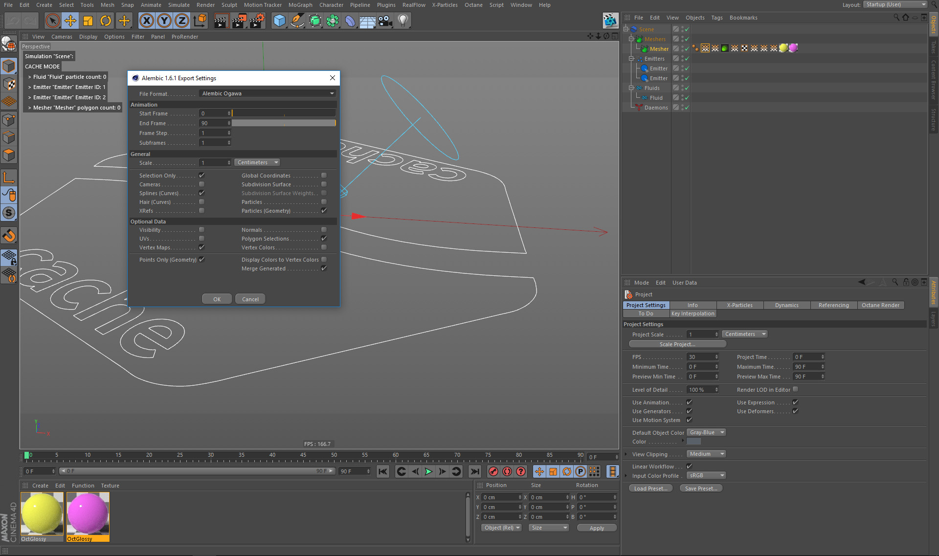

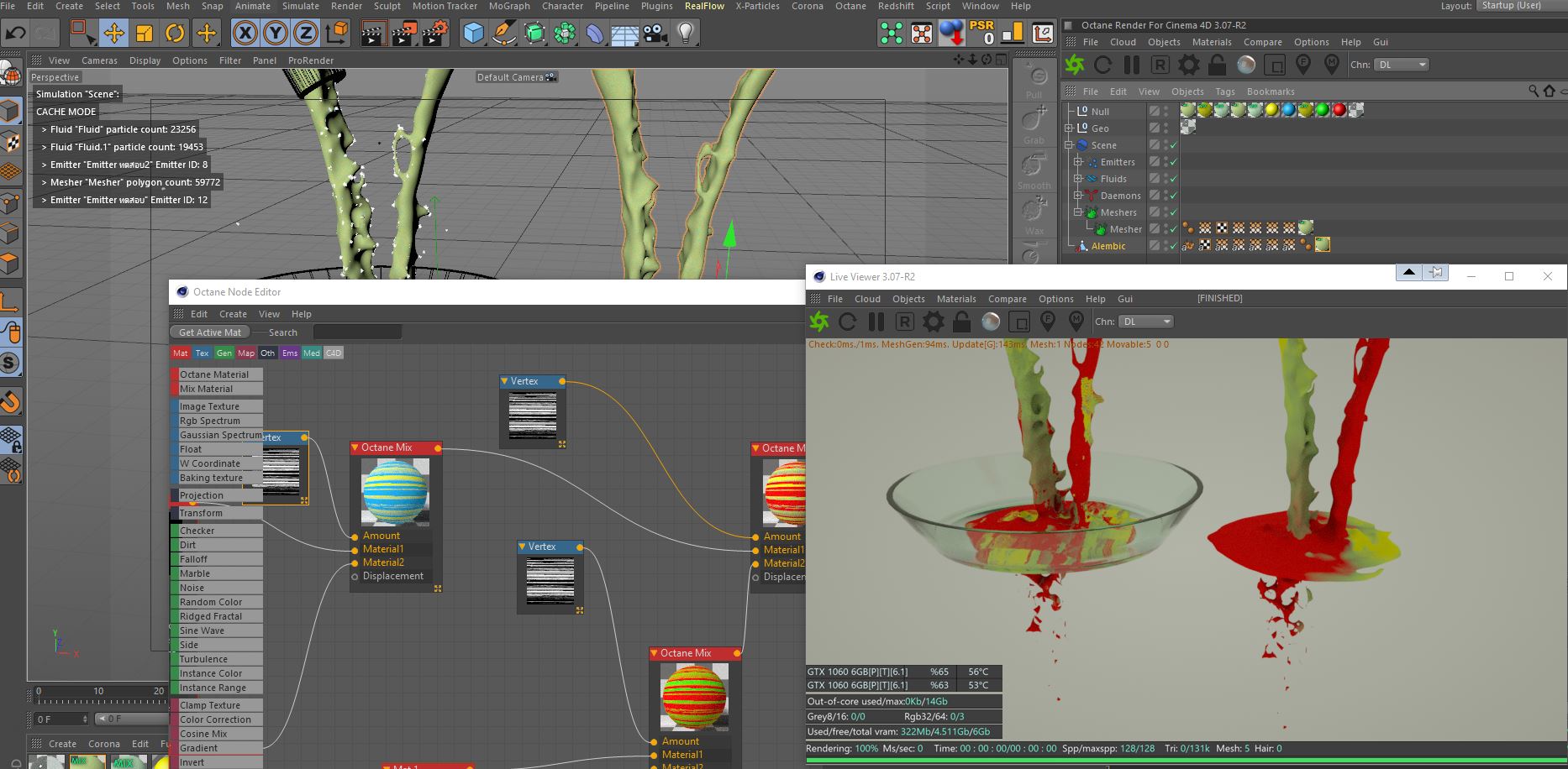

I think octane not understand New realflowMesh.
Try to export Alembic include Vertex map option . i test correct with Mixing fluid Animation. RF 2.5 Octane 3

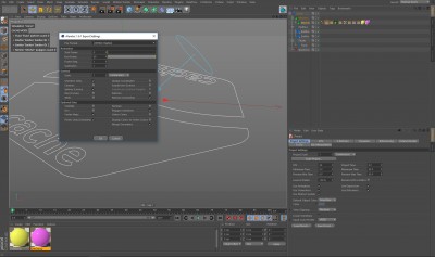

Thank you cglism, with Alembic there are 2 main problems:
1. It seems to work only with 1 VM, everytime I try to swap VM in the Octane Mix Material's Amount it doesn't evaluate the new VM, it stays the same, even restarting the Live Viewer.
2. How do we import Alembic sequences in C4D? RF writes one file for each frame and Alembic is supposed to be a big unique file with all the frames stored in it.

Hey Domenico, after u cache ur particles/meshes, empty scene and export only the liquid as alembic and u ll have a unified ABC file. Cheers
