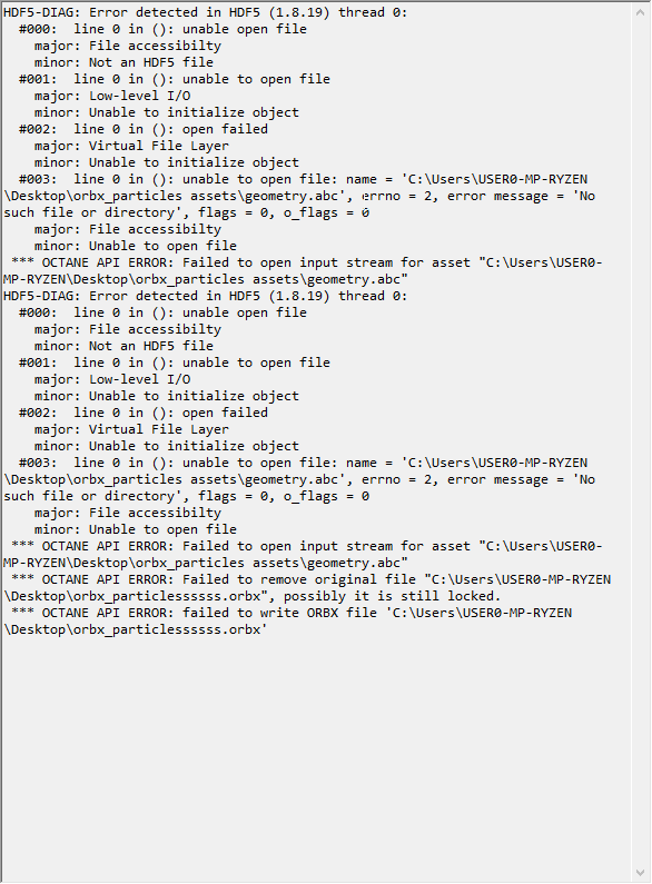

Jumping in this thread. ORBX is so freaking amazing I just imported millions of particles in c4d with Cd/pscale, so so happy!
One thing, it exported every time (while couldn't replace an existing file) but kept popping this error.
I'm new in H so I might have done something wrong in my setup so here is also a scene:
https://www.dropbox.com/s/nh7i1cs46acux ... hiplc?dl=0
Thanks!
james_conkle
Posts: 162
Joined: Sun Oct 27, 2019 10:28 pm
Location: Brooklyn, NY
I tried Thanulee's scene and after I cached the scene and removed the HDRI it exported the ORBX without error... until I tried to export an ORBX again with a new filename. Then I got the same error but the error referenced the name of the previous ORBX. This goes away when I quit Houdini and load the scene again.
Feels like it's expecting to render the ORBX with the same name if one was rendered during the same Houdini session.
I was able to successfully open these ORBX in standalone even if they had the error in Houdini.

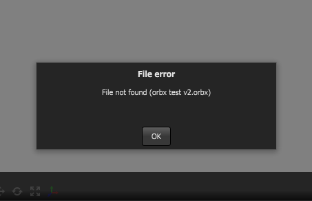

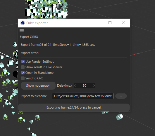

ORBX files are also not showing up for me in Cinema 4D. Pic of the error is attached.
Here's the C4D project. Link
Could it possibly have to do with moving Octane's AppData/Local/Roaming folder to a different location? Or maybe could it be a license issue? I just got an enterprise license, but my studio license hasn't expired yet.
