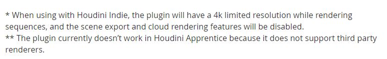

To render a panorama, (still image 4096*2048) I wanted to go through your services. ORC
Apparently this is not possible because of the Houdini indie license :
"The scene export function are disabled due to the houdini indie licencse restrictions"
I haven't read this type of restriction anywhere. Locally I can make this type of format without any problem...
I don't understand this limitation for the cloud . Do you have a solution ?

Sorry, somehow I had not seen this post. This restriction is part of the agreement signed with SideFX to allow that our plugin could work in Houdini Indie. The rendering resolution while rendering sequences must be limited (now to 4k) and any kind of scene export function must be disabled. Exporting scenes to the cloud is also an export scene function, so it must be disabled in the plugin while working on the Indie version.
We have this information in all the forum release topic notes and on the website, even on the purchase page. Sorry about that.
