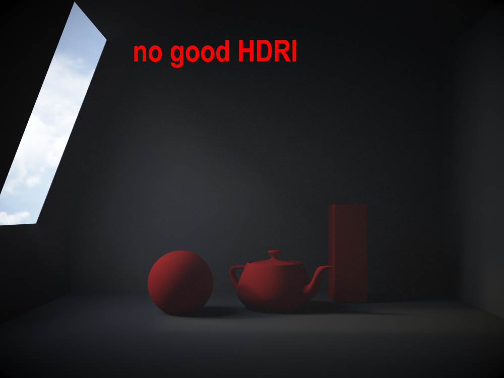

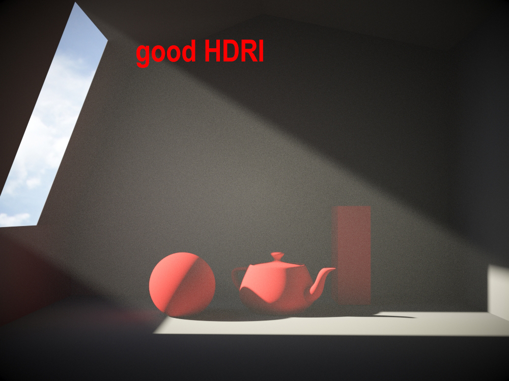

.. it's imported from zbrush, I usually jump back and forth via the GoZ script, which takes care of import stuff..
- also now when you're here, can you explain how to efficiently use the scatter volume in the HDRI, or how to achieve some fog there - struggling a bit with settings not sure which way to go

acc24ex,
thanks for the reply, It is useful to understand your issue.
About fog and hdri:
Operation same as with physical sun.
links about it.
viewtopic.php?f=21&t=56599
viewtopic.php?f=27&t=56810
Specifically, the result depends onHDRI; high quality HDRI as produces good shadows cast, works well with volume effects.
As you can see in screenshots, I used two different HDRI with same features but different quality.
Different results with the same volume settings.
Regards
Paride
