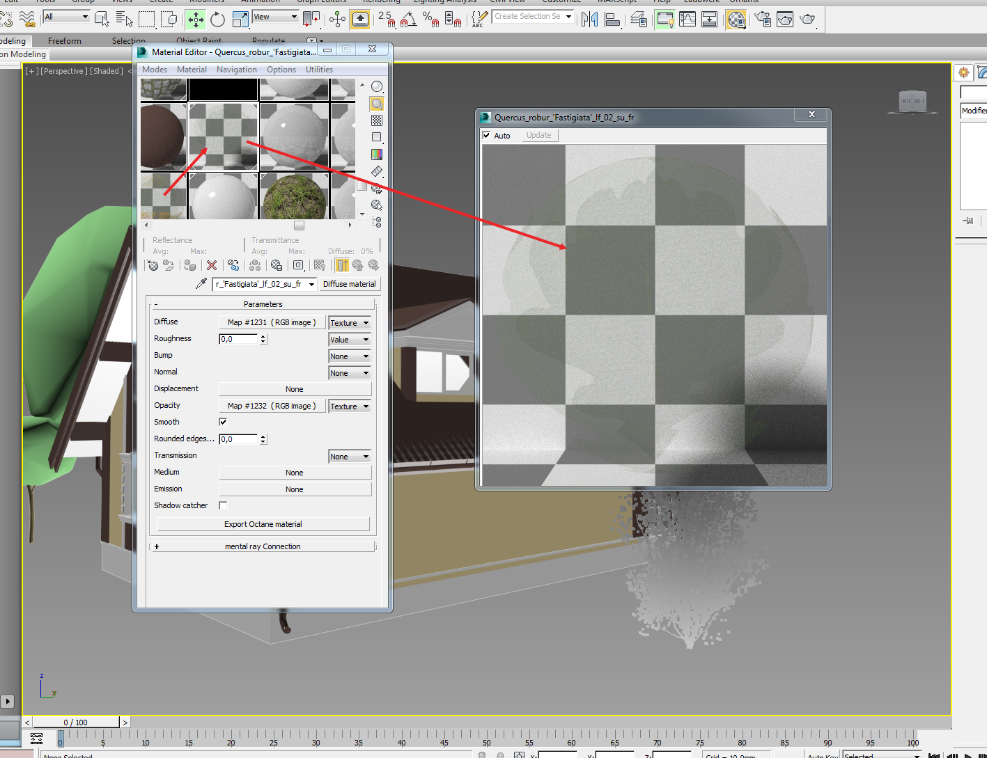

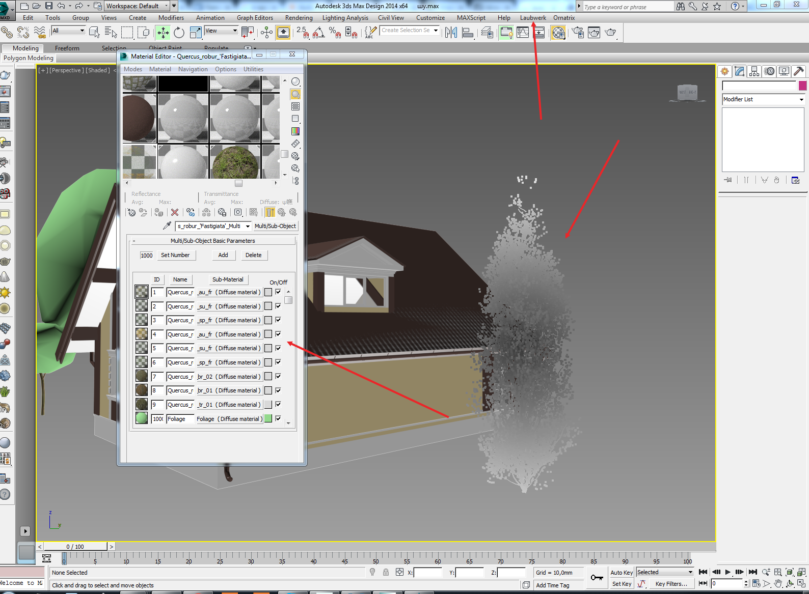

laubwerk plants kit 1 2 3 Conversion does not work materials
laubwerk plants kit 1 2 3.rar
(55.42 MiB) Downloaded 328 times

paride4331
Posts: 3933
@Elvissuperstar007
Hi Elvissuperstar007,
There are a lot of differences between how material types are defined in V-Ray vs Octane - V-Ray materials are based on value ranges of key attributes,
while Octane materials are explicitly defined types.
Interpreting some of the more vague VRayMtls into it's correct Octane counterpart continues to be a thorn in the side of this converter.
It has been improved upon, generally believed that the V-Ray issue will never be 100% resolved,
but it can always improve and it is what developers will do.
Thanks for collaboration.
Regards
Paride

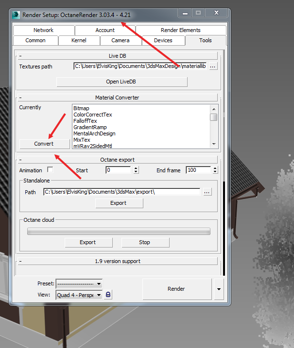

paride4331
Posts: 3933
Hi acc24ex,
the material converter (release 4.21) works properly.
I attached the mini-guide to properly convert materials.
If your problems remain, please tell me about.
Regards
Paride
-- Mini guide to the new integrated material conversion system: --
Purpose: Load max scenes containing octane objects and materials created with octane plugin version 2.23.2 - 1.9 and earlier.
-Conversion system need to be activated first. 3dsMax need to be restarted for this activation / desactivation to take effect.
-The 'Activate' check box let you select the activation status; a message 'Change will take effect on max restart' is shown as needed.
-On the left of this check box, the current activation status is displayed.
-Note: this 'activation' may use a little bit more memory for the converted scenes. Once saved, and reloaded, this should come back to normal.
It is recommmended to keep the system deactivated when no conversion is needed.
-Minor changes in render result are to be expected, mostly due to evolution of Octane renderer itself, and maybe in incomplete old parameter conversion (that would be issues to be fixed).
-A good way to check if the conversion is fully correct is to export the scene from the 1.9 plugin as orbx and visualy compare the result between the standalone and the 4.18 plugin.
Notes:
Loading an old scene with the conversion deactivated seems to occasionally cause some issues.
