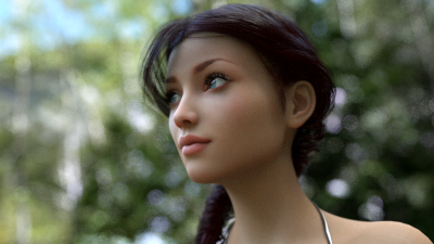

A bit better lighting. :mrgreen:

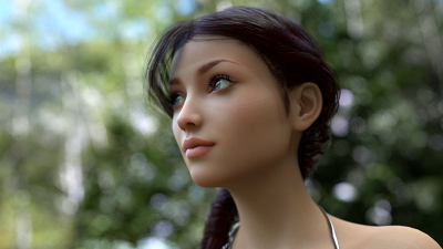

However I am noticing a few artifacts that I can't seem to get rid of. In the image below, you can see some "scaling" on her cheek and chin that appear to be interpolygon shadows. Lowering the ray epsilon helped a bit, but this was as low as I could go.
Also, the shader seems to react oddly to transparent objects (whether by transparency map or even a material or object set to "Hidden") The shadow on her forehead and temples is caused by the transparent skull cap of the hair.
Any ideas?
How much of a presence in the light calculation of the render do transparent objects have, Paul?

For the scales, check that smoothing is on. I had an issue where it was suddenly turned off for a material.
Any ideas?
Looks like the skull cap is inside the models head, so is effecting the SSS calculation.
And for her cheek, it looks like smoothing is off.

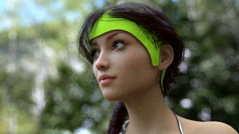

Yeah, I checked for smoothing and it was on. (on both materials in the mix)

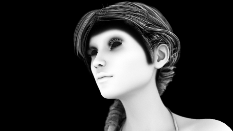

As for the shadow, I did some testing by expanding the hair to make sure the cap was outside the mesh:
As you can see it seems mere proximity is enough to cause the shadow:

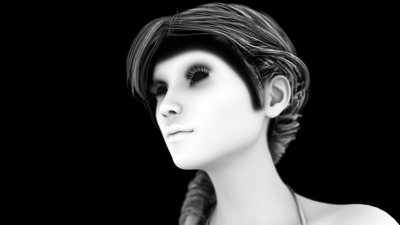

Checking the infochannels seems to imply that AO is the main culprit...

ThetaGraphics wrote:Yeah, I checked for smoothing and it was on. (on both materials in the mix)

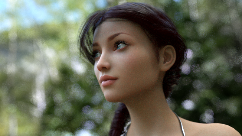

Some info I can provide. Turning up the subd makes the "facets" go away. I usually render at subd 3+ for the hd morphs. As for the shadows of the skullcap, this is an octane issue, and how transparencies are handled with specular materials. Since it is a double spec material with each material having a different SSS scaling you get the results with skull caps as you can see. Because of this I'm trying to perfect a new setup to work with daz hair. I only ever use this original shader if I am using fiber mesh hair, which is sad, I really like the material setup.
ThetaGraphics
Posts: 74
Joined: Sun Feb 03, 2013 11:10 pm
Yep, increasing subd seems to have fixed the facets. Thanks.
