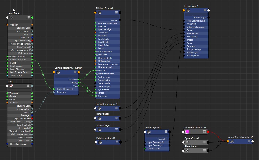

Nice. Dropping a reference of what seems to be the minimum to start a render and how to plug the camera. May be obvious to people familiar to Octane Standalone, but not all Maya users.
@k.a.schubert, I know this alpha is just the barebone and you probably have a better idea to quick start renderings.
But before it's too late, I hope you didn't miss my suggestions to make the setup accessible through the familiar Render Settings window:
viewtopic.php?f=28&t=53709&start=80#p279066
Also, please do not overwrite 2.0 (unless you plan to make old scenes compatible :mrgreen: ).
"Scale (1 unit = X meter)" is messing with the position of the camera (I guess the CameraTransformConverter isn't factoring it).

Thanks for the pic, made me realize I need an empty Geometry Group connected to the Render Target to see my scene, was wondering why I'm only seeing my Daylight Environment.
