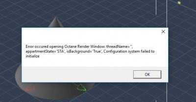

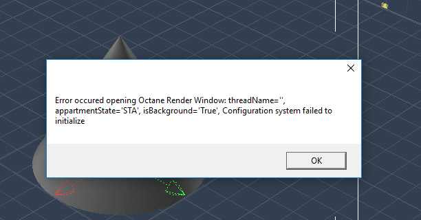

Hi there,
I've had a problem with the last few versions crashing Carrara. Octane will run once to register, but when running, I get the attached message. After that, Carrara refuses to load new scenes, and I have to uninstall the Octane plug-in if I want to create a new scene.
Error occured opening OctaneRender Window: threadName=",
appartmentState='STA', isBackground='True', Configuration system failed
to initialize
Noel

Nod64 wrote:I've had a problem with the last few versions crashing Carrara. Octane will run once to register, but when running, I get the attached message. After that, Carrara refuses to load new scenes, and I have to uninstall the Octane plug-in if I want to create a new scene.
to initialize
It looks like you might have a corrupt settings file. Please try to locate and delete all the plugin user.config files located in your AppData directory:
Mine were located here:
C:\Users\Simon\AppData\Local\DAZ_3D,_Inc
Within that directory you should find sub directories that look something like 'DefaultDomain_Path_g2zzw5wbksxx0yrpq5z0fnxllbxkqvav'. Just delete any that you find and then restart Carrara.
Note that the AppData directory is hidden by default so you will need to go into Explorer settings to make it visible:
Open explorer. Select the View tab. Enable 'Hidden Items'.

Nod64
Posts: 28
Joined: Thu Feb 14, 2013 12:34 am
Location: East Kilbride
Hi there,
That did the trick.
