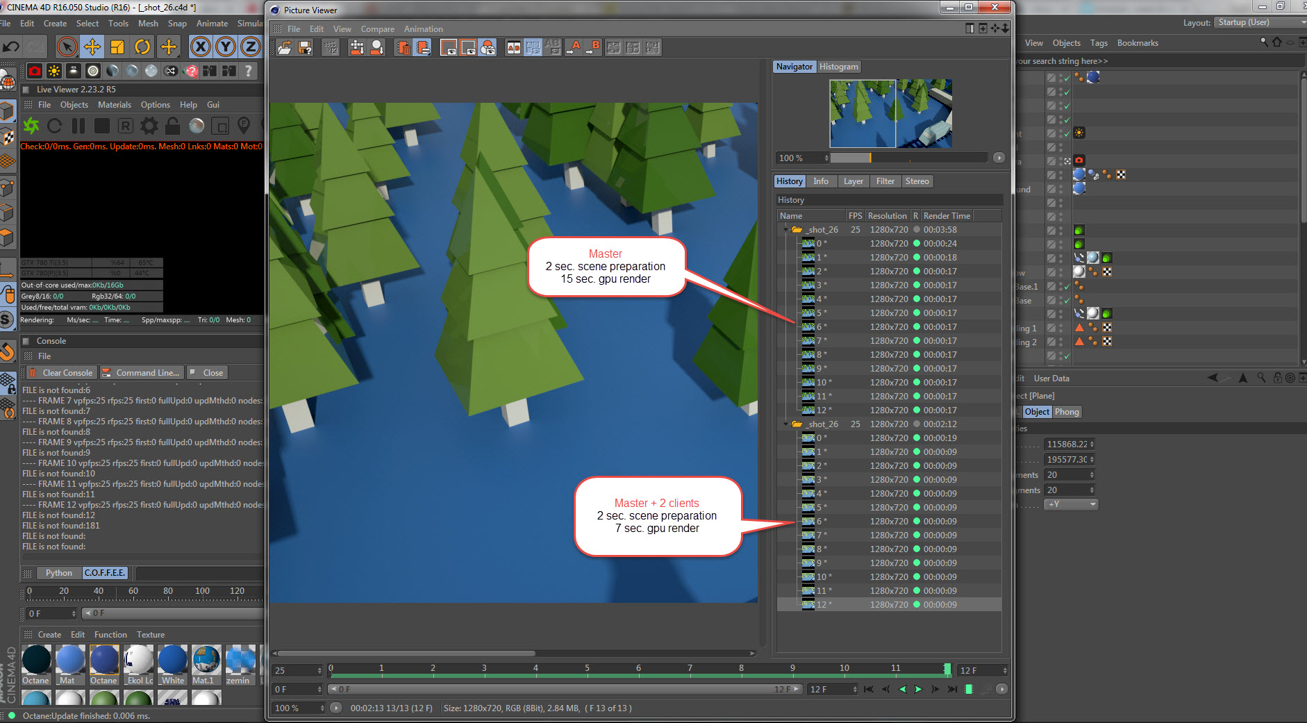

Here is a picture to show my results. As you can see, network rendering is definitively faster. Master has a 780, a client has also 780, other one has 680.
Secondly, I couldn't reproduce your issue here. Works flawless. Also i'm sending a test version to check. I have made a small change on network function. I hope that will be better.

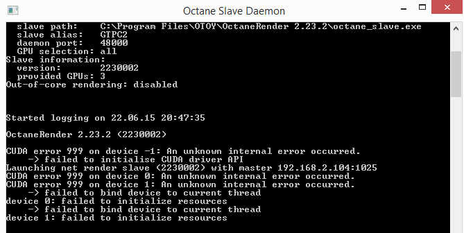

I was performing a similar test for you and received this error message on the slave after rendering 1 frame:
The GPUs referred to are both regular Titans that perform well on their own as of today.
PS - I tried updating to the new 353.30 Nvidia driver shortly before this. It runs great on the master. I may try restoring my slave right about now.

Your last screenshot indicates a GPU crash on the slave. Does it happen reliably? I.e. if you stop the daemon via CTRL-C and then restart it using the _run_installed_daemon.bat and then using it for network rendering, does it immediately crash?
