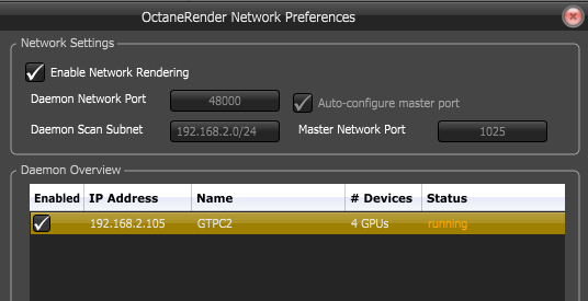

I thought it would have went without saying that I have set the network preferences and double checked them many times but here are screen shots to prove it.
Everything behaves like normal except the data transfer rate remains at "0", the slave does not contribute any computation, and the render takes approx. 5-10 seconds longer than if I were to turn net render off.

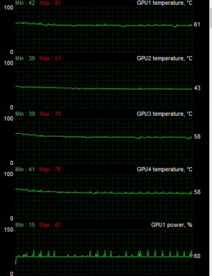

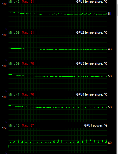

This screen grab was taken of Afterburner on the slave while trying to render in the Picture Viewer right after rendering at full capacity the exact same scene in the Live Viewer. It seems to begin rendering at each frame but it quits right away.
Also, temps do go up a tiny bit during this process but this machine runs hot and when really rendering, the gpus go up to 75-80.

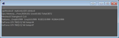

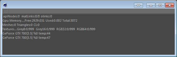

probably also the frame buffer is the answer, one thing you can do before starting the render, is to go to the liveview menu>Help>Show GPU info:
In this way you can monitoring how much VRAM consumed in Picture Viewer, and if you exceed the slave VRAM, you have some troubles.
